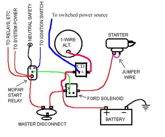

This is a good way to do it, per our member @crackedback.

good info guys, much appreciated! I am going to locate the battery behind the drivers seat or in the trunk on the dr side. Rusty in your diagram what is the CD box?
So, I think I would run the Battery + wire to the LINE side of the Master Disconnect. Then the LOAD side to a Buss in the engine compartment to feed the relays.
