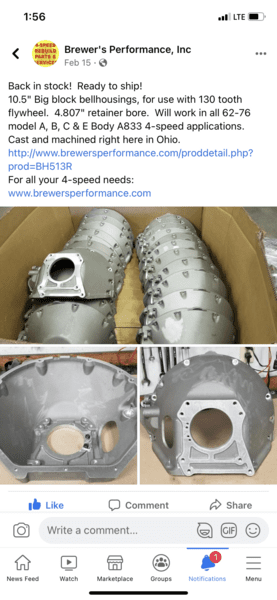

there was a factory 10.5” big block aluminum bell for 70-01 B/E bodies and it has the 4.80 retainer opening and will work in an A body. #2892513
Lakewood makes a nice aluminum bell. It fits the big 308 bearing front retainer and also has spacers included for other sizes.
Lakewood LK6000 Lakewood Bellhousing - Big Block Mopar
I dont think there were any OEM big block bells in aluminum. Someone correct me if im wrong on this. If you want factory iron, search for PN 2892626. Im sure there are other compatible factory bells.
Sure they made them in aluminum.
'70 and up big blocks had them, but they were for the 10 1/2'' clutches with 130 tooth flywheel and had a 4.807'' opening for the bearing retainer.
2892513 is the number for them.
