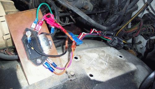

This is an inexpensive adaptor kit that fits good and looks nice. Comes with all the hardware, spade terminals, heat shrink, and detailed instructions on how to wire it up. All for $25 shipped.
For those who say the module needs to be mounted away from the engine, you are wrong. The module was designed to be inside a distributor in the first place. That is a hot environment, plus you want the module as close to the dist pickup as possible.

I guess Johnny dart thinks all HEI module installs are hack jobs done by rednecks. heres the pix of my stock dizzy after i overhauled it, and added the HEI to it. first pic was right after i rebuilt it.
if your gonna do one of these brackets, i recommend dissassembling the distributor first, as you will have to tap the 2 drain holes for 8-32 countersunk mounting screws. and remove some casting flash on the distributor where the bracket has to sit. the holes are correct sized to just go at it with a tap. i modded my housing while i had it all apart for the rebuild, then added another drain hole opposite of the module.
