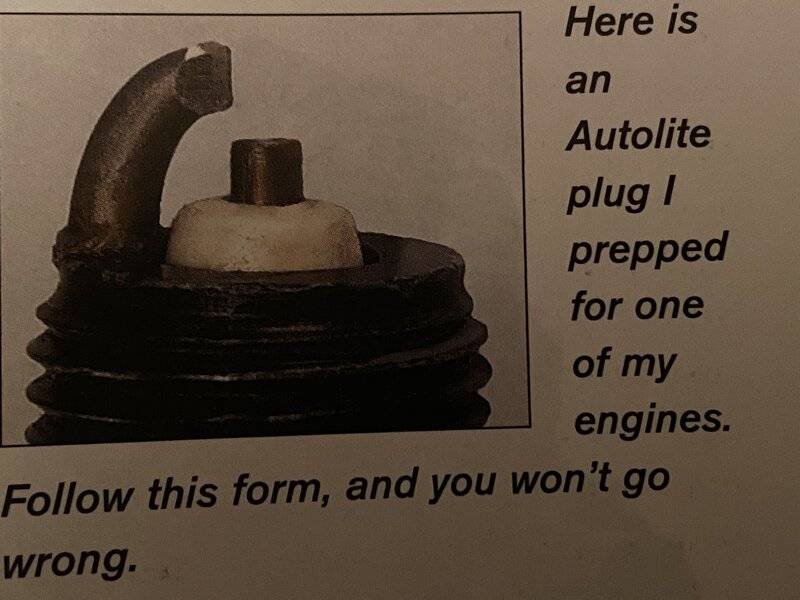

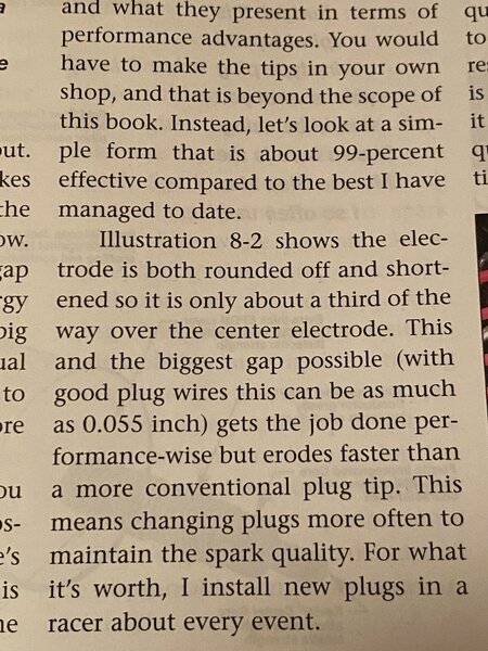

David vizard in his Holley carb book
Talks about rounding the ground electrode on spark plugs to unshroud the center electrode for better flame travel.
Also keeps the plug cooler.
I did it recently on a set of plugs in my 340
One thing I've noticed is no more pinging
On acceleration that it used to do occasionally.
But he also says they don't last very long.

View attachment 1715854813 David vizard in his Holley carb book
I’ve done that to a set of Autolite race plugs like he mentions, even though the end is ground back and rounded there is still a 90° edge. Kind or a tedious job grinding and trying not to hit the center electrode as you grind but a neat mod nonetheless
Yep that's what I'm running too
Autolite 3924R
It was tedious and took some time
I used the end flap off the spark plug box
To put in between the center and ground electrodes to keep from damaging it with the file.
They still look great after about 1500 miles
I was running the standard Autolite 3924's
Before switching to the Race plug.
I think they are a click cooler plug by design also.
So far So good!
You should be able to buy Autolite’s with a cutback ground wire. Everyone else makes one.
These are what I used on motorcycles. One of the thinnest center electrodes, able to be made thin using iridium in order to last. Any benefits observed was due to that 0.4mm pinpoint thin center electrode, not the metal
IRIDIUM POWER - Features | Products | SPARK PLUG | Automotive Service Parts and Accessories | DENSO Global Website
Glad you posted this. If you have a weak ignition system, any fine wire plug can show an improvement. If it does, you are better off upgrading the ignition system than using a fine wire plug.
Yes. Vizard mentions the race Autolites that are already cut back, but he cuts them even further back as shown in one of his books. I did that and indexed them just because, not that I could ever tell the effects.

Along with sharp edges, the side electrode prep, from Vizards “How To Build Horsepower” book:
