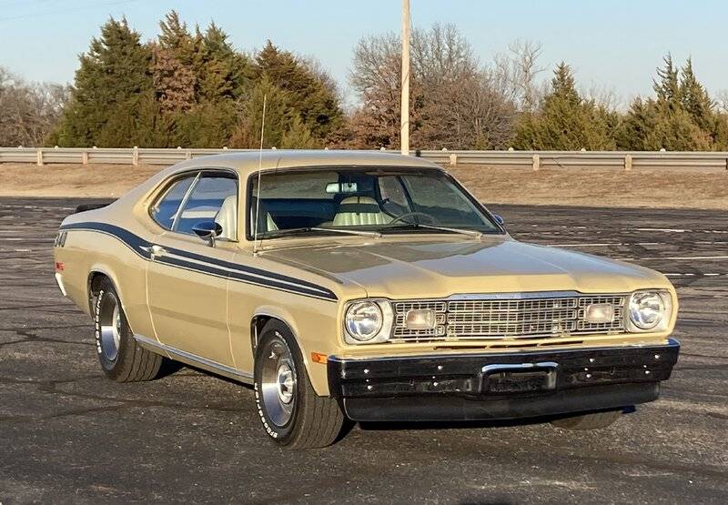

What diameter? I run a 225/60-15 (26”) on a Valiant Duster. I had to extend the front fender support rod a little and roll the lip just a hair. I’m on 1.03 torsion bars and decently low. Conservative 255 on back but will consider 275’s if I go 3.55 rear. Nothing to do with headers though.

Have you posted up in the wheels and tires forum under what tires your running so everyone knows what can fit?
Also, what wheel and offset and tire brand are you running?
