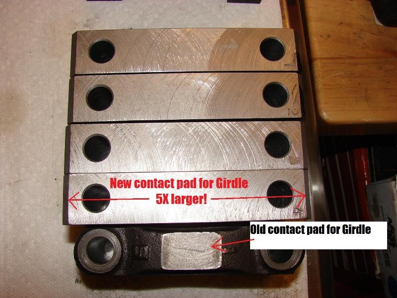

Yeah, no need for the girdle at that power level, but the best way is to machine the caps. Personally, there isn't really any good girdles out there. That's why we build our own ;)
1/2" girdle
Machined caps along with one un machined cap. Spot milled rear cap to match...

This is our setup and they have proven to be very good over anything else we have done. I would never mill a Stock cap done that much, they are not that strong to begin with. They are not nearly as strong as our 4140 caps
But like what was said, at your power level its not realy needed unless your going to go for more and more power. A set of ARP main studs will do the job.

We never had an issue with our stock milled caps with the 1/2" girdle, and we definitely worked that stock block engine HARD! But I sure like your caps! Never seen them before! I will keep you in mind. How much power have you put through a stock block with those bad boys?? I would assume the caps aren't the weak part of the block anymore with those.
