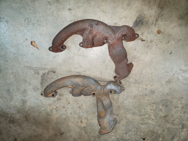

A 67 B body 383 was given a 325 hp rating, same engine as in the A body except for the exhaust manifolds. Want to see how much better the 67 B body manifolds were? Here you go (A body top, B body bottom):
By the way, here is an A body 383 driver's side manifold compared to a 340 driver's side manifold. Remember, the 383 got a 2.25 inch pipe coming off it, the 340 got something like an inch and 7/8, PLUS is had a huge dent in it to clear the torsion bar.
Now, because the early A body 383's had fewer rated hp than the later ones, many assume the later A body manifold was better. Well, I have one of each. The later A body manifolds were designed to clear power steering, not gain horsepower. Look at them side by side. The late manifolds are flatter (narrower) than the early ones to go around the steering box. The late manifolds also make a sharper turn to go down to the exhaust pipe flange.
Here, late top, early bottom.
Here, early left, late right.
I haven't flowed these two manifolds, or dyno tested them on a running engine, but the early ones sure look to me like they would flow better.
