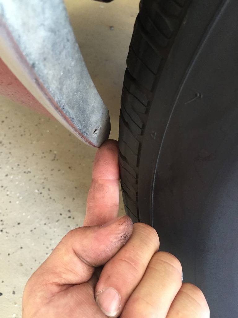

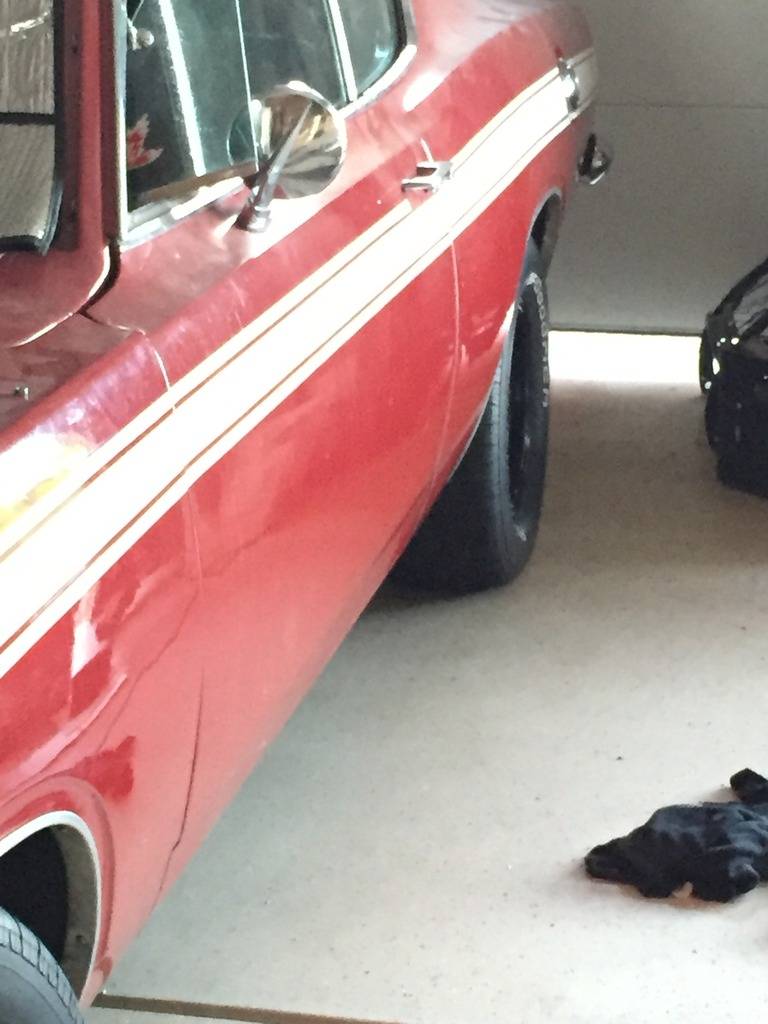

Well, it's like this: 245 rubber all around. Looks cool on the back but a bit too marshmallow on the fronts and certainly not an approved width for the rim size. Will probably go with 215s for the fronts and just count the tires I pull off as handy replacements for when the rears are all chewed up.

Probably unsafe for anything but that one test. Those tires looked like I inflated a tube directly on the rim.
-Kurt
That's more a problem of too much sidewall. The tires I have on the fronts, now, are okay in diameter but with such a wide tread section, the shoulder gets real close to the wheel arch when steering. Narrowing the tread will help and I'll be sure to get an appropriate sidewall ratio.

I'm having the same problem you had in that the clearance is more of an issue during full turn-in so I'm looking at just putting narrower rubber on to pull the shoulder of the tire away from the fender. Not to mention, 245 is way bigger than I need on the front and, honestly, too big for a 6" rim.

Is that a 245/60-14? That would be 25.6" tall and be on at least a 7" wheel. A 225/60-14 will give you almost 1/2" more clearance in the diameter and fit the 6" wheel just fine.

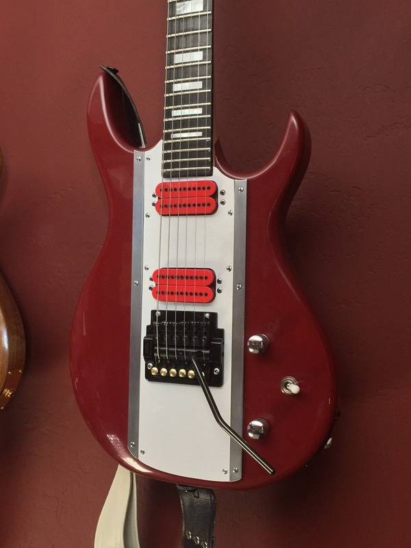

Project complete! Behold!

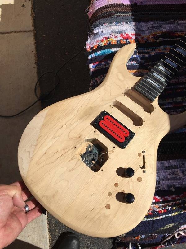

Started out as a green guitar I bought off eBay in November, 2000. It was a non-original finish and therefore not worth much. I didn't get around to sanding that paint off until 2004.
Someone had already done a few knob and switch changes so doing a translucent stain was out of the question.
When I pulled it back out this summer....
Routed it out for 2 double pickups rather than a double and 2 singles. This meant I would have to add a pickguard to cover the surgery.

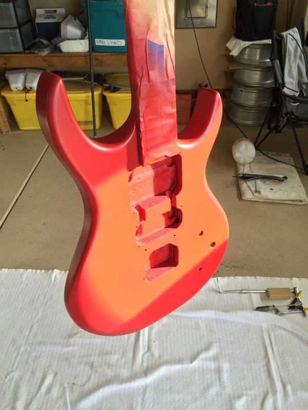

Primed

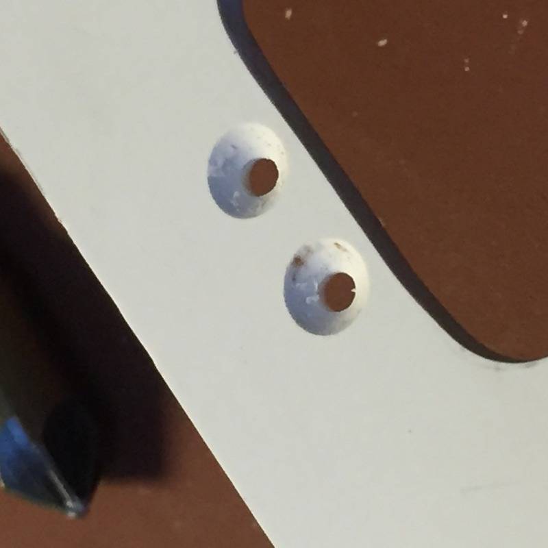

The kind of details you would expect...
Fabricating the metal trim. Bright red pickups are a nod to the car's engine.
Paint
