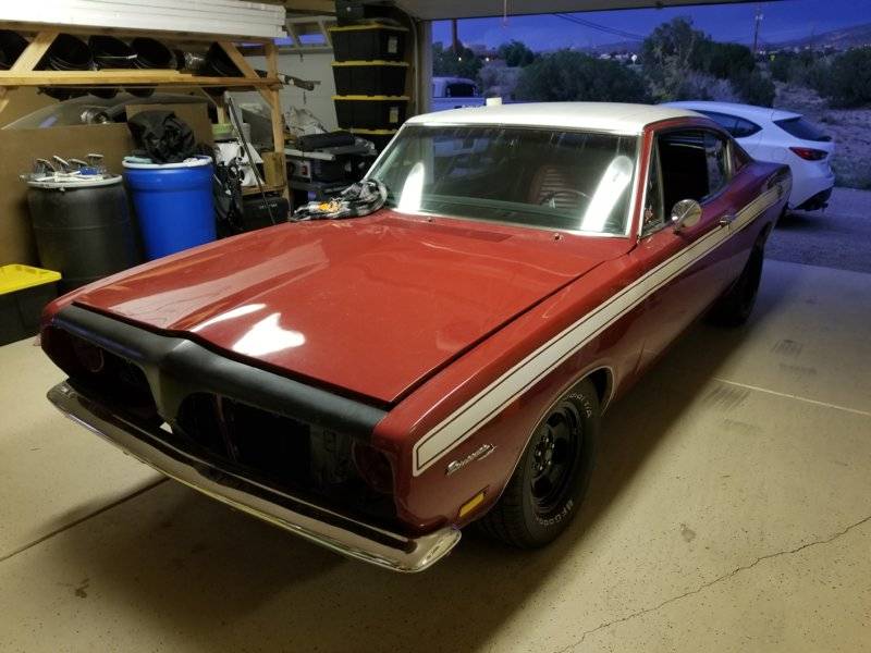

                It looks so small here where I'm used to seeing either my truck or the wife's VW. 15335222093313661071046835312872.jpg

                      Fo shizzle. Our 2009 VW CC isn't really a big car at all but it is longer and wider than the fish.
