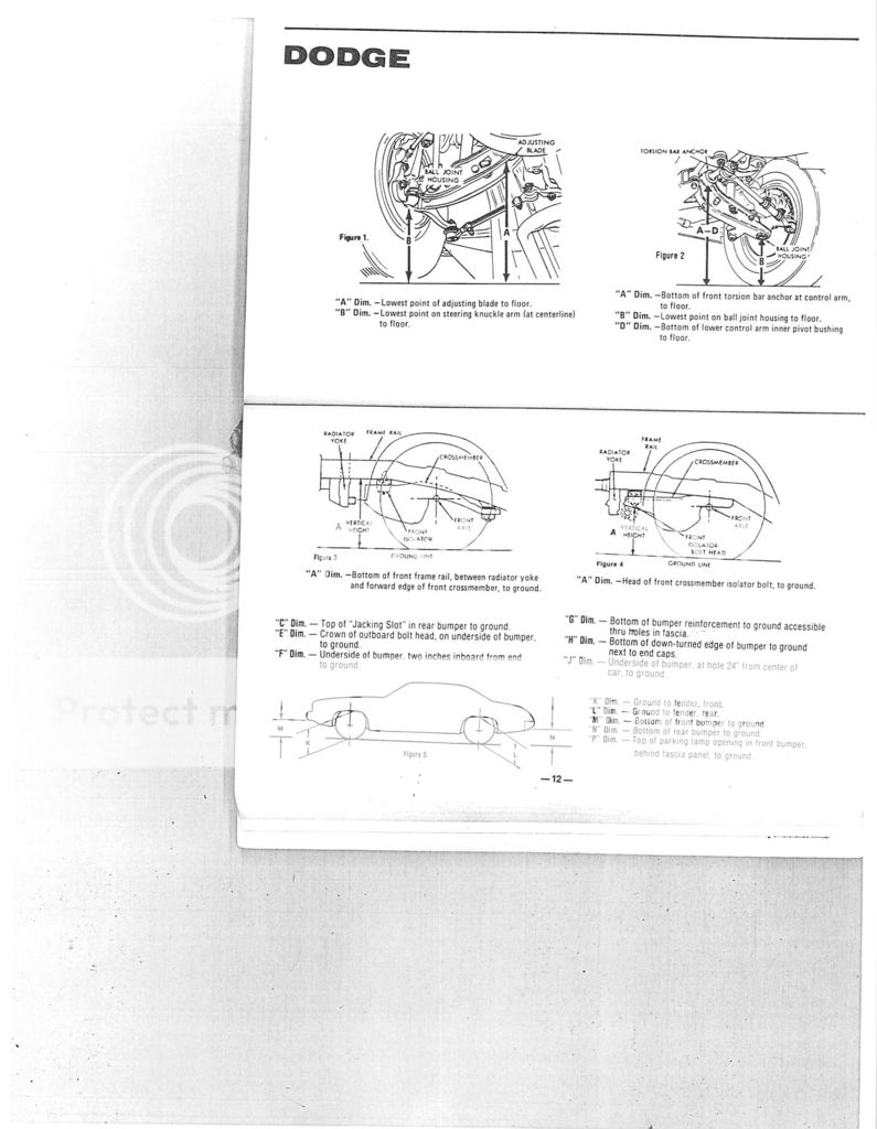

Here are the ride height dimensions if you don't have them. I would inspect your entire front end and possibly adjust or replace the torsion bars.
I didn't know those ride height measurements existed! My FSM for my Scamp doesn't
have those details. Do you have the ride height measurements for a '68 Dodge Coronet 440?
