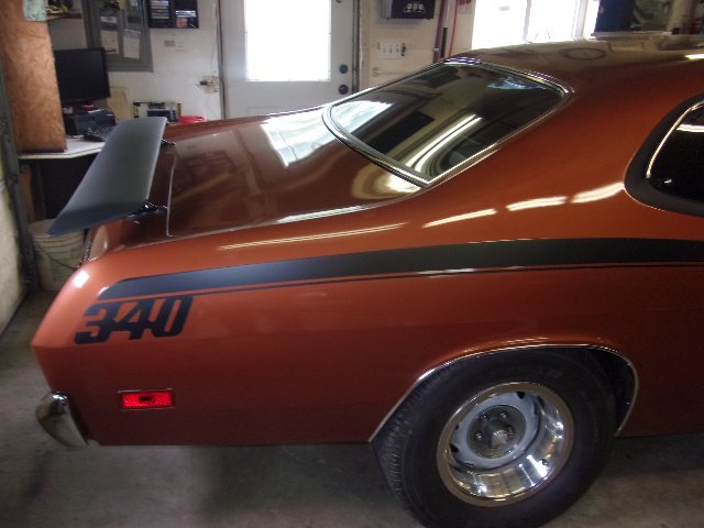

Car looks nice . What you did was the right thing for that car and very practical . When you are not this guy you actually have something worth showing for your efforts. -
