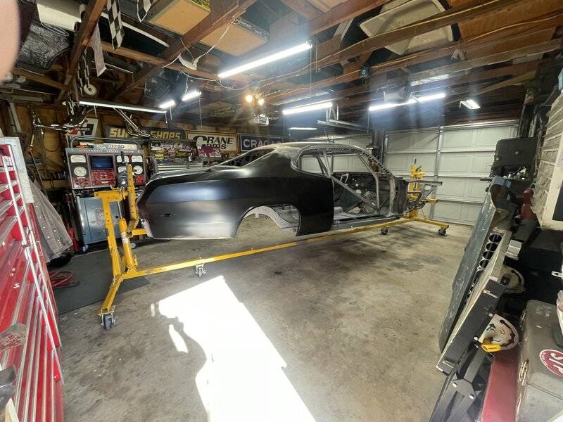

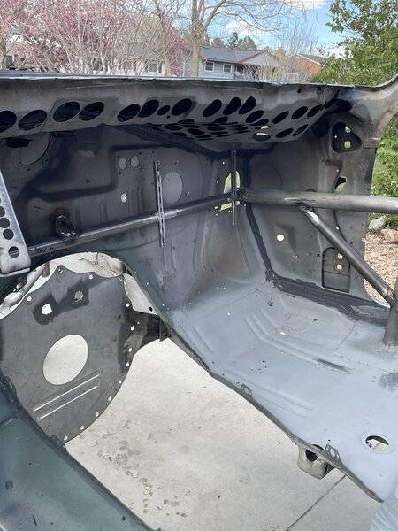

Crazy morning—took the day off to get the roll cage welded out so I could start on the underside, but of course, the welder was a no-call no-show. Thankfully, my buddy's coming in clutch to help out
My buddy from Colorado Hot Rod Haven (AMBR and Riddler builders) came out to check over the cage and the parts they’ll be working on. He should be back within the next week or so to knock out the cage work, which means I can finally lead the seams and roll the car over to start on the underside.

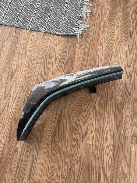

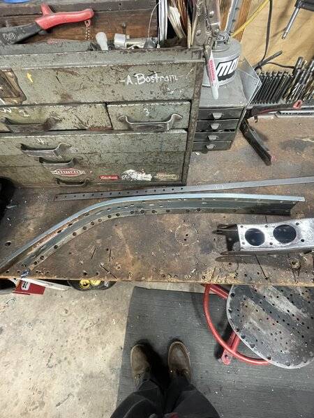

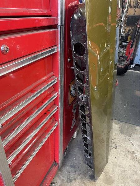

Another buddy came through big time with a passenger side drip rail—sending one down from their private yard. I also wrapped up the bottom edges on the doors, so those and the drip rail are heading to the blaster, hopefully later this week.

How are you gonna deal with the aesthetics of a 25.5 cage in this thing?
I'm staying with a 8.50 cert cage but incorporating some parts of the 25.5 spec. That way if I must update in the future the foundation is there but I don't plan to push it past deep eights (that would be outlaw events anyway) otherwise I still have my FED chassis for when I want to go faster.

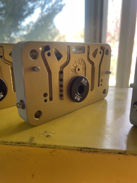

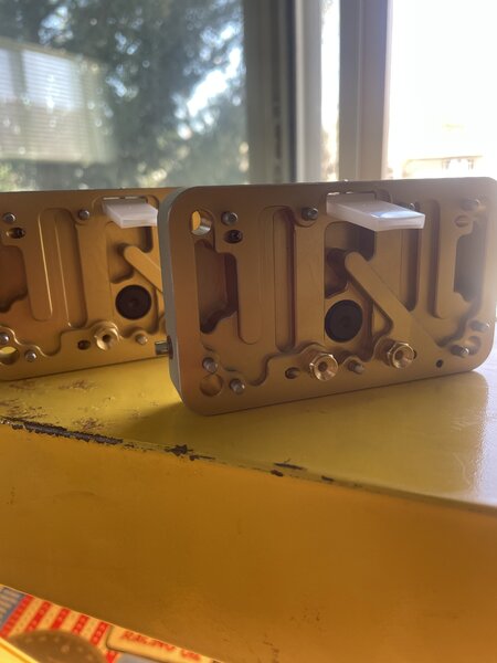

Jewelry for the Pro Stocks just landed—BLP (Bo Laws) metering blocks and the craftsmanship is absolutely top-tier. Huge thanks to Mark for making it happen. One step closer to the finish line and the Cam Motion booth at PRI!

Huge thanks to the crew at Colorado Hot Rod Haven for coming out Friday and knocking out the top side of the chassis—flawless work as always.

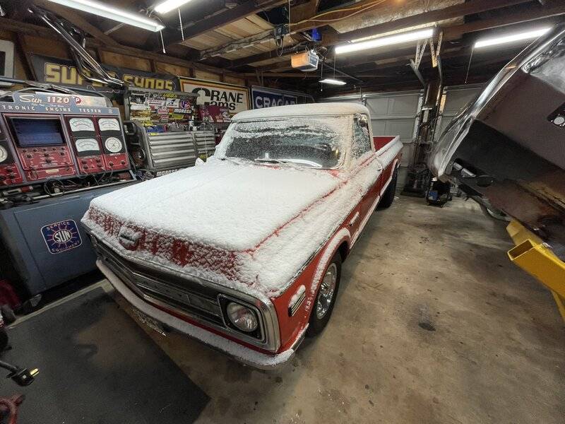

The C10 had to get shuffled out into the snow (which killed the battery—go figure), but hey, looks like we’re getting a white Easter for once.

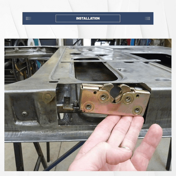

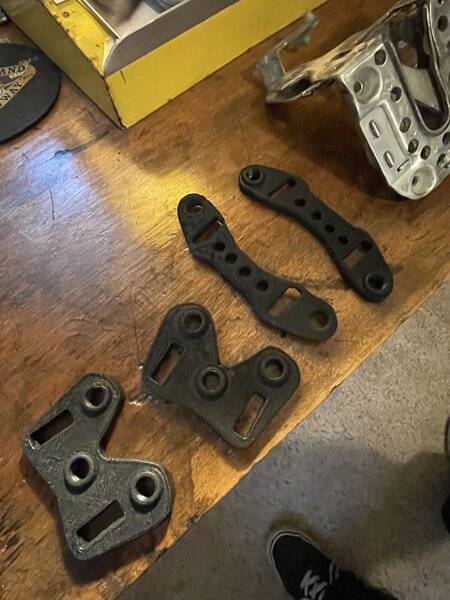

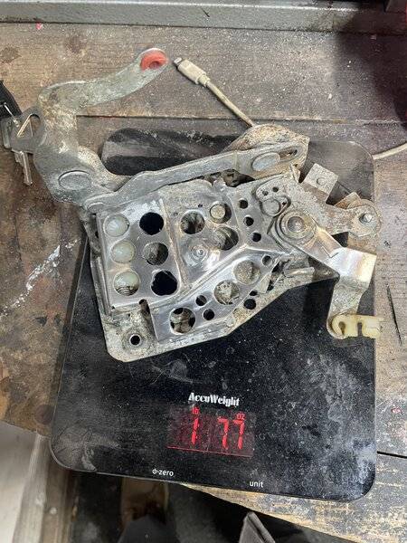

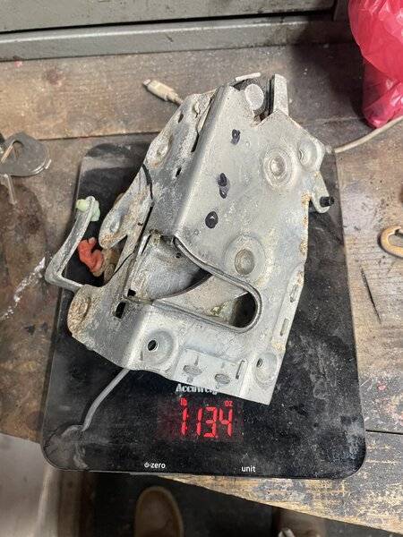

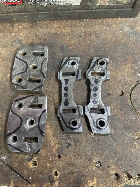

In the “every ounce counts” mindset, I dug into the door latches. After weighing a few ideas—replacing them, recreating them in titanium—I decided to stick with modifying the originals. Ended up going the classic route: carefully drilling them out for weight savings while keeping safety intact.

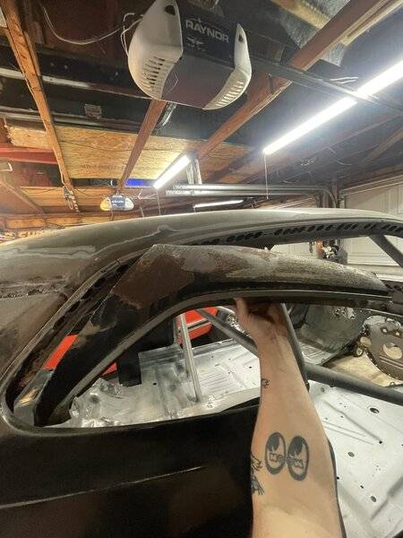

Next up this week: with the drip rail spot welds are drilled, both doors, skin and the rail are heading to the blaster. Making progress!
Lot of effort for 6 oz.! Better than nothing but has to be a bit frustrating to only net a few oz. Kinda like when I spent two days stripping grimy-*** undercoating off my Duster thinking it would be 20 + lbs. and it only ended up being about half...
FMJ on B bodies Only just went through a mini ordeal replacing a steel oil pan with an aluminum one that only ended up saving a couple ounces.
its not super frustrating as every bit adds up and like with the body @209.6 lbs it added up its just patience and dedication to a goal at this point
I work with thousandths, tenths and grams.
6 ounces is a lot lol

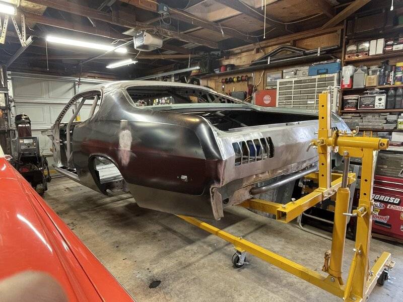

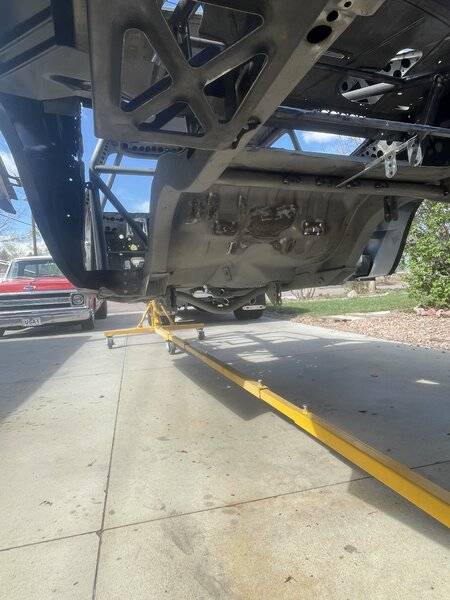

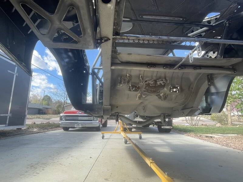

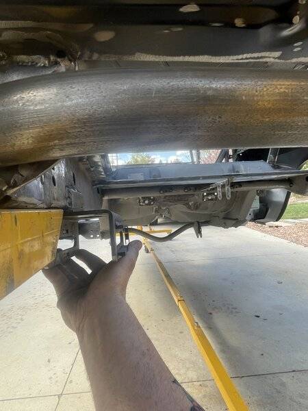

Spent the afternoon buttoning up final prep to roll the car over onto its lid. In the process, I ran into a new decision point on the rear frame layout. My original plan was to flip the inner edge of the stock rail to become the new outer edge, then follow the factory contour with a new tube. But after looking it over, the cleanest and most structurally sound solution might be to remove each rear frame rail entirely and shift them inward in line with the front rails. That way, the chromoly subframe connectors will run straight into the strongest parts of the chassis.
Also knocked out a few lingering details from the last few days—lightened the door latch mechanisms and trimmed down the inner door bolt mounts, cutting about half the weight from each. Drilled out the drip rail too, so now the doors, rail, and sectioning pieces are ready to head to the blaster.
