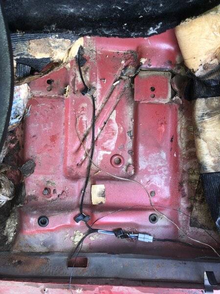

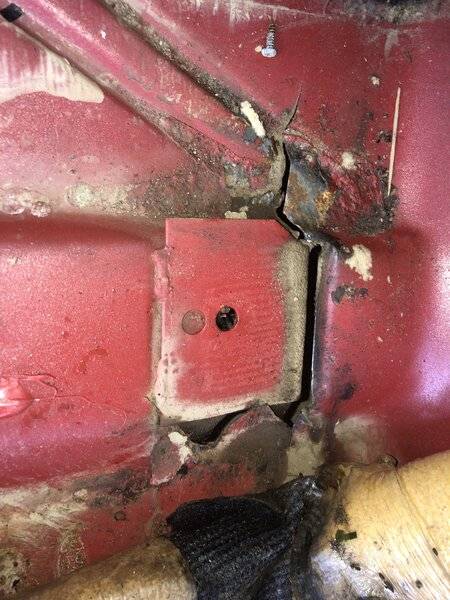

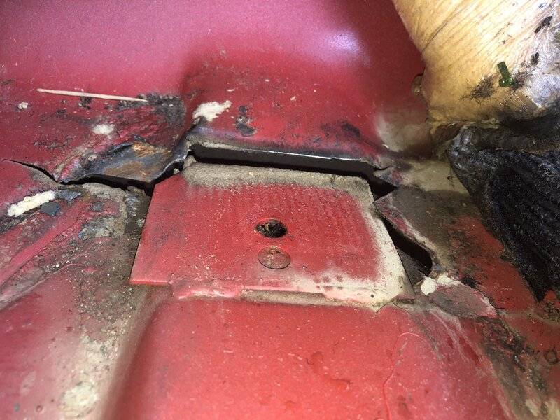

1973 Duster drivers side. I have Zero welding experience. A buddy I have welds a bit but not on cars, a novice. Wanted to ask what’s the best correct and cheapest approach to making this solid and able to last ? Types of welds and materials that should be used ?
All the metal around bracket and crack seems solid. Appreciate any help. Thanks.

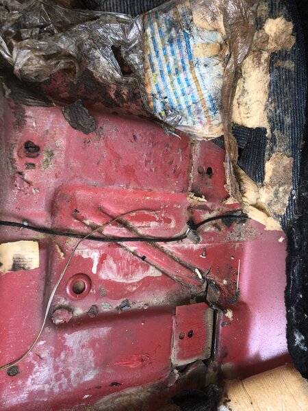

Awesome photo of a broadcast sheet being found under the carpet!
Do what you can to gently remove it for preservation.

Remove the floor brace . Overlap a piece from another car flanging it with a flange tool. Plug weld it on and weld the seam from the underside so you cannot see the seam. Replace the floor brace and you are done. Looks like it broke from a heavy weight like me sitting in it for many years. Don't butt weld it your wasting your time it will brake again unless it is tig welded. That would take a lot of cleaning of the metal.
A bench seat car would have a good piece of donor metal to overlap that. Add the bucket plate right back on top of it.
Thanks. Was able to save about 70% of the broadcast sheet. The cars always been an automatic. So should I put a wanted ad for that section of the pan ? Only use a bench seat donor ... so when I put my bracket back over it it’ll be level ? How much overlapping with the donor piece should be done? What would take a lot of cleaning of the metal the butt weld or the tig weld ?
Donor metal from a bucket seat car could be just as stresses and weak as what you have. The metal thickness wont cause a noticeable difference in level. I would think that bucket seat back is stressed and leaning anyway.
