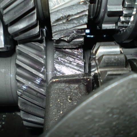

Seriously; you broke third gear on the street?
For my street car that 2-3 shift is at like 85mph and the tires are still spinning;
What's your traction secret?
You gotta have more than them slapper bars.......

Cal Tracs and some M/T ET streets. The RAM clutch is what destroys everything. Here's a picture of 3rd gear.
