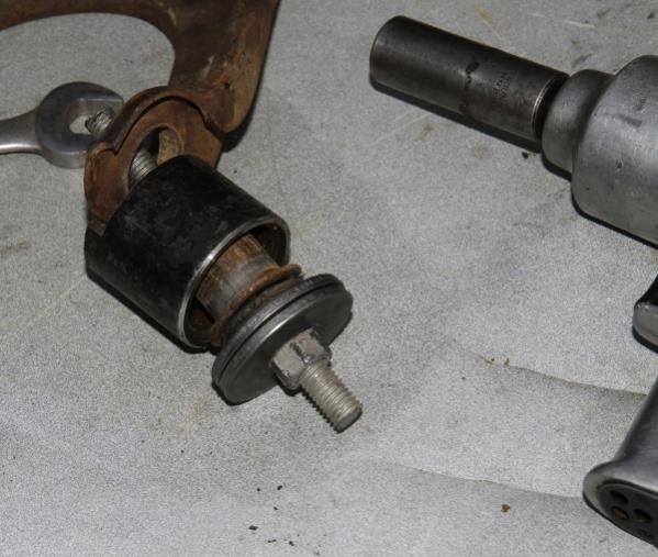

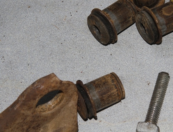

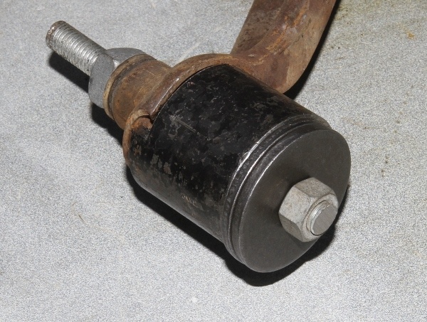

I made one for very little money out of pipe fittings:
http://www.forabodiesonly.com/mopar/showpost.php?p=1970076957&postcount=163
Got a steel pipe coupler. These are normally used on the ends of 20' lengths of pipe for thread protection. Around here, only malleable iron couplers are used operationally.
I clamped it in my Drill / Mill and cut a notch for clearance. You don't need a mill, you can do this with a hacksaw, as it's not critical

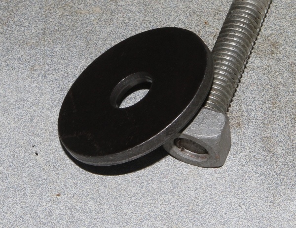

The bolt is a scrap of 1/2" allthread. This is course thread, you should use find thread, grade 5 or 8. You should be able to buy a 1 foot chunk from a decent fastener's store
I bought some (called locally) "flat plate washers." These are not only very large OD, like a fender washer, they are thick as can be, maybe 3/16" ? "I used two" LOL
I could've gotten the new ones in, but the arms really should be cleaned up[/QUOTE]
