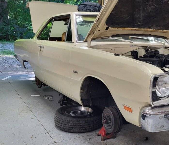

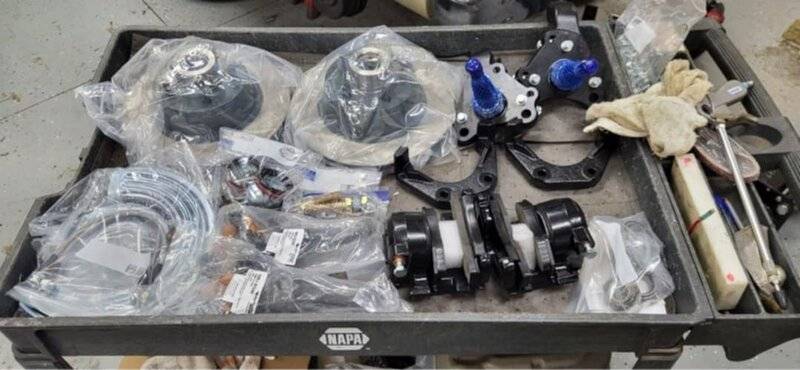

I am in the process of swapping Doctor Diff 11.75 front disc on my car. Very high quality kit. I had an issue where bearings would not slide onto spindles easily tolerances were too tight. Had to use 80 grit sand paper on spindle and bearing inner race to open up tolerances a tad. Usual car project type bull ****. But got past that issue. Luckily I test fitted and found that problem before i packed bearings with grease ect ect ect....

The largest piece of slag, in the picture, fell out as soon as sat it down.. The rest from running a screwdriver around. I ended up putting a barrel sander on my die grinder and cleaning it out.
Did stuff..

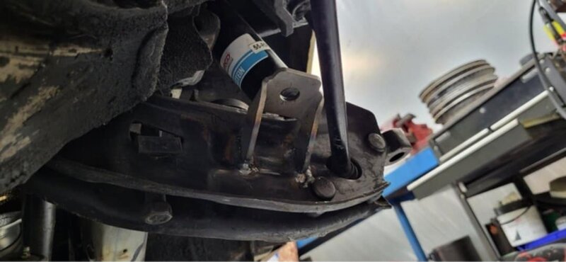

11.75 Dr Diff brakes installed, 15x7s painted and Hotchkis sway bar brackets welded on. My 15 psi residual valve was supposed to be yesterday.. Wasn't. Itll be here today. So I once I have it, I can get the system bled. The spindles changed my tie, drastically. Almost to the finish line..
