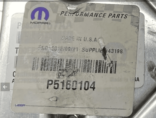

So when looking at a GPEC2, the label will have a part #, a Serial # and a OS #. The standard OS numbers are like 68228325AD, 68370557AD, etc. But if it ends with RV, it's a Mopar crate ECM. Now, since mine is special, oh so special, the most special, the label does not match what is actually flashed to it. When I retrieve my OS info in HP tuners, my OS is a completely different # than the label and ends in RV. Meaning that at one time, it was just a a standard ECM, but has since been wiped and flashed with something entirely different... It's not a copy of a RV but as I mentioned, it has roots.

Found this image of the back of a crate PCM, if it helps?

I have a few crate ECMs.. one in hoopty and one on the shelf. The one on the shelf is P5160105 (5.7). Under the label should be OS info. Crates don't have a VIN like stock ones. I kinda even wonder if the OS is actually there there? Is it a stock one that just flashed to an RV and then a label put over it. Hmm. It'll show in HPT tho. I looked up my part # for the one on the shelf and in the description, its actually different than I believed... This makes it sound like it adapts.
P5160105 Description from Summit..
"Mopar Performance Stage 1 engine control modules work with your power adders to maximize your Mopar's performance! Designed for race-only applications, these Stage 1 engine controllers have modified spark and fuel tables that kick in when mods like headers, cat-back exhausts, aftermarket cams, and cold air intake systems are used. The computer senses the additional airflow and will compensate with appropriate fuel and spark for the best performance possible. Make power adders perform with Mopar Performance Stage 1 engine control modules."
