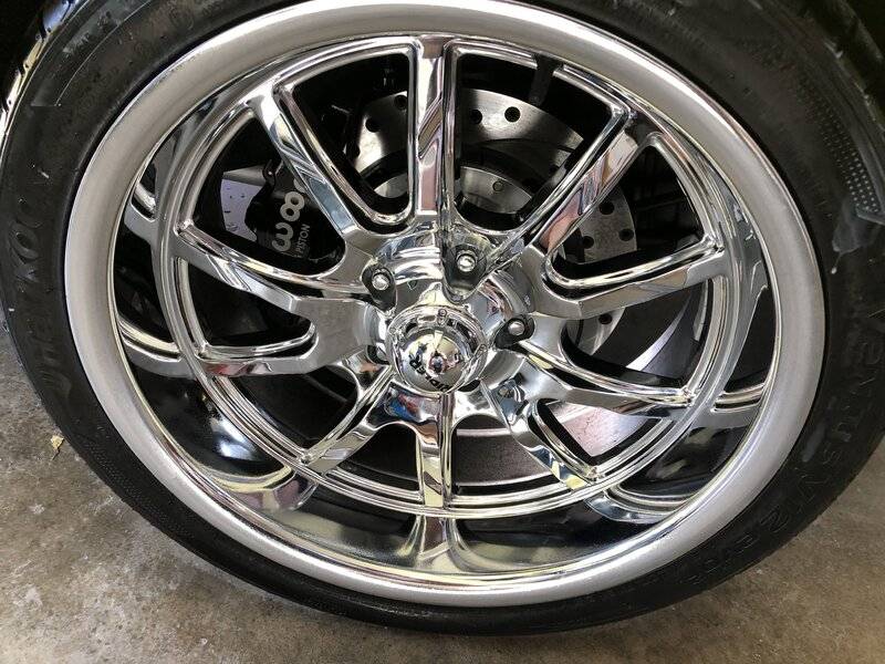

I bought my car with Wilwood brakes including 6 piston calipers on the front and they really don’t impress me in the least. My car has manual brakes but still for the money they are underwhelming. And with Wilwood brakes they have a larger hub thus limiting your wheel choices. Because of the size of my front rotors I have to run 18” wheels.
they are a little bit more pleasing upon the eyes
What wheels are you trying to run that you are worried about how the brakes look behind the wheels? Unless you are running thin spoke wheels or you are parking with the wheels off and the car on blocks I would focus more on brakes that are easy to get parts for and work well for the performance level needs of the car. In most stock to mild performance applications stock type brakes will be sufficient. If you are autocrossing or other sanctioned racing events then by all means, go wild cause stopping a car is more important than making it go. But buying brakes purely on looks may not be the best avenue to judge. Just curious here.
It sounds like everyone here autocrosses/tracks their cars and if you don't do an oem conversion it's a big bad deal lol... I have Brembos on my daily and Spartas on my racecar, so I understand good braking systems and their impact on a car. I will not be autocrossing this car, nor will it see track time as I have a dedicated car for that. This is just a fun weekend, show, cruise car... Even if the Wilwoods (or another like company) get 10% less braking power I prefer the look... also, brake pads are more important than the caliper they are matched with (assuming relatively same build quality); funny how no one has mentioned pads, just calipers.
No idea why anyone would put 6 piston huge brakes on an a body... what does not impress you with the brakes? Are they still on the stock pads provided by Wilwood? Most stock pads, even from Brembo and big companies, really stink compared to aftermarket ones.
I bought my car with Wilwood brakes including 6 piston calipers on the front and they really don’t impress me in the least. My car has manual brakes but still for the money they are underwhelming. And with Wilwood brakes they have a larger hub thus limiting your wheel choices. Because of the size of my front rotors I have to run 18” wheels.View attachment 1715802172
Simply put the Wilwood brakes do not stop all that well. No better than any pedestrian car that’s built today. Maybe I’m just used to all my previous cars and current company car that run Brembos.
They do look good behind my wheels though.
You're not really making sense here. I don't just run OEM brakes anymore, I run DoctorDiff's 13" Cobra style kit. Heck you've got another member with Wilwoods telling you not to get them. The reason you're getting comparisons and suggestions to go OEM is because the OEM brakes will outperform the Wilwood kit you're looking at and still fit 15" wheels. If you want to go aftermarket then there's plenty of options that will flog the wilwood kit you're looking at, but most of them won't fit with 15" rims.
Also, you can get decent pads for the OEM slider style calipers. Firm Feel has options, you can get the whole range of pads from EBC for the stock slider calipers, and Bergman AutoCraft is taking interest in carbon/kevlar pads for the stock calipers too. But if you're just driving on the street a decent set of semi-metallics will be more than fine for you. And since you say this is only a cruiser, I'm not sure I see why you need something other than regular old brake pads.
Uh, to stop the car better? With the better tire compounds that you can get for larger wheel diameters, not to mention wider tires, even A-bodies can make good use of high performance brakes.
