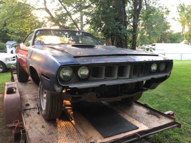

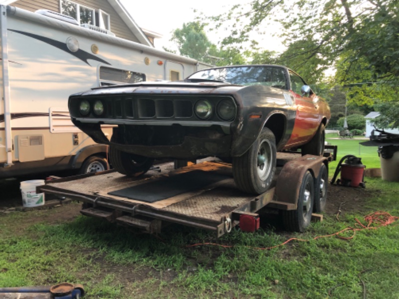

Tap on the LCA with a hammer and make sure it’s all the way down. I had that same problem with the 71 Cuda, the torsion bar broke sometime about 30+ years ago, and for the life of me I couldn’t get the damn thing to clock. Pounded on the LCA and it dropped a little more and that did the trick. Make sure the LCA shaft nut is also loosened.
