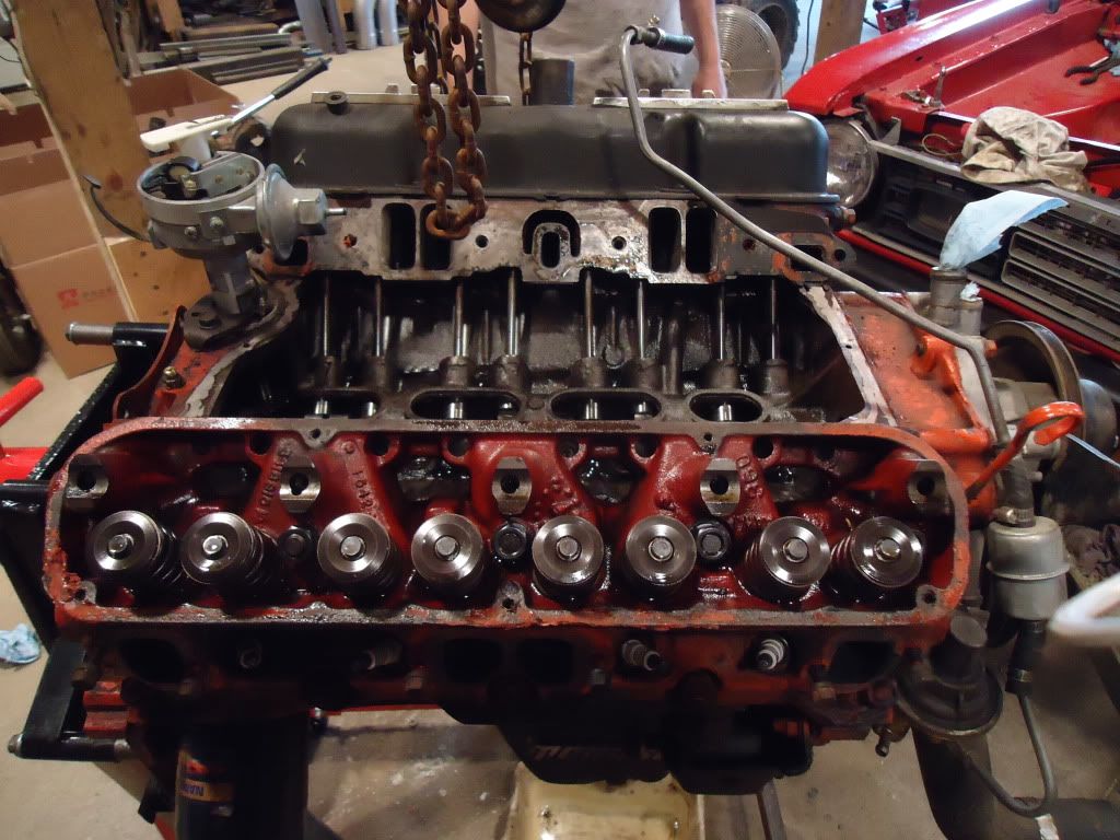

sorry, i work midnights and i have been on 12s all week, haha. i do NOT have a Hydraulic cam. i meant that some of my rockers had 1/16th+ play in them, as in i could slap them up and down from the valve to the push rod, thats how loose they were. a guy i work with used to drag race a challenger and he told me to set lash to seated plus a quarter turn. i didnt do that, i just went to where it was seated for fear that the valves would stay open, like someone mentioned. i am not sure what cam is in it, when i had it apart i didnt measure anything, i just know the guy i bought it from said he didnt want me running it on the street cause he used it for the strip and it was too wild for the street. this is the best pic i could find when i had it apart...
http://i156.photobucket.com/albums/t8/gullo53/DSC00159.jpg

i do NOT have a Hydraulic cam............ i meant that some of my rockers had 1/16th+ play in them,........... i just went to where it was seated for fear that the valves would stay open, i am not sure what cam is in it, http://i156.photobucket.com/albums/t8/gullo53/DSC00159.jpg
If you don't know what cam you have, you just as well plan on getting something "you can use" and changing the thing.
