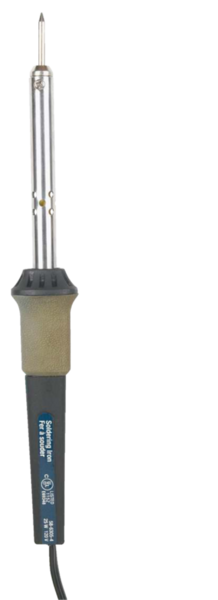

Align the seat bolt locations in the floor pan then, use a pencil style soldering iron to punch the holes through the carpet.
