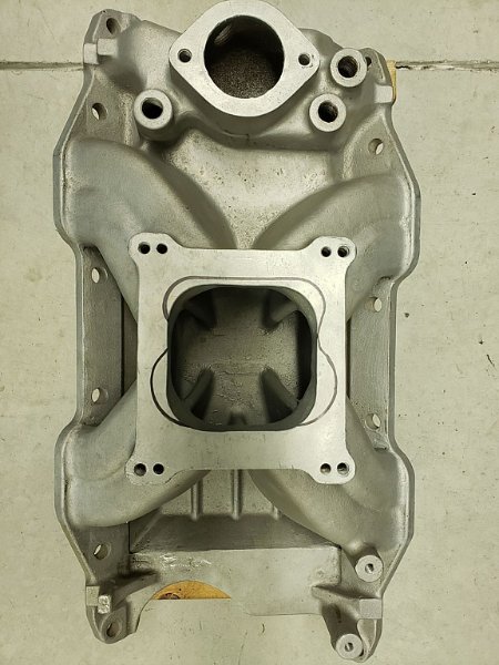

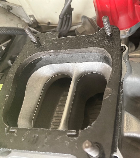

Do you have a picture of the carb adapter on top of the intake manifold? Might reveal some clues.
FWIW, the photo has the adapter set up I run on my stroker 360/410. 850 TQ, Edel.RPM dual plane. You can see there’s some plenum area under the carb. May not be absolutely optimal, but it runs well, no bogging or over rich condition.
FWIW, the photo has the adapter set up I run on my stroker 360/410. 850 TQ, Edel.RPM dual plane. You can see there’s some plenum area under the carb. May not be absolutely optimal, but it runs well, no bogging or over rich condition....
So I had originally thought of adapting the W2 intake to a spread-bore setup, but sort of 'chickened out' seeing as I did not know to what extent reworking that intake top would impact the 'designed-in' flow characteristics.
I've attached a couple of photos of what I'm talking about:
1) the gasket contour showing the trimming of the carb mounting pad I would have to do
2) the adapter (3/4" thick) which I am still using on this intake, but which I was previously using on my Performer RPM

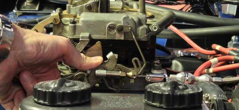

Yeah, so "THAT ONE TIME" I swapped the bottom plates.
I use the Lokar cable setup for both the throttle and transmission kick-downs, which means that I really should re-check the cable operation each and every time. To be honest nothing should have changed with just the plate switch...alas, that wasn't quite the case!!!
Turns out I somehow lost about 1/4" linear cable travel. In terms of this translating to a degree (rotation) of the throttle, well, it was enough to leave the secondary butterflies opening maybe 2/3 of the way at most.
Now I know I said earlier that this was checked to make sure the secondary plates were fully opening, and I know we did this...but somehow I missed something. My wife was helping me (not a fault of hers) but the two throttle return springs I use make for a heavy gas pedal feel and I recall her saying she "couldn't push any further" LOL, and me telling her "just floor it honey"...ha ha...oh boy! Anyways, I could have sworn we even retested with the springs removed, but I can't argue the reality here, the linkage was off.

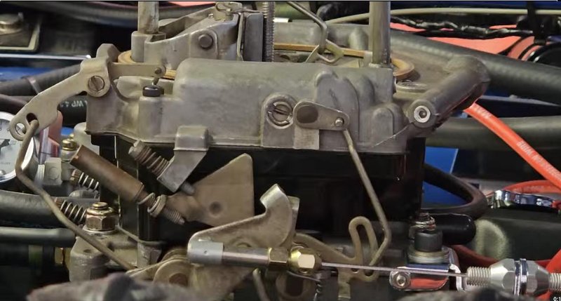

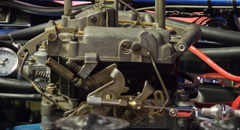

Take a look at the attached pics:
1) MOPAR_TQ_WOT_throttle-problem - shows the problem in that the secondaries are NOT fully opening
2) MOPAR_TQ_WOT_throttle-manual - shows the FULL opening when manually forced
3) MOPAR_TQ_WOT_throttle-linkage_fix2 - shows the corrected FINAL setup
I properly adjusted the cable and reverted all the other setups back to where they started, took the car out for a test drive and was immediately rewarded with:
