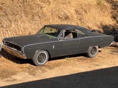

This car.....
Looks like crap but is a fun dirt road drift car. It has a fairly stock mid 70s 360 with a stock bottom end, a 280/474 Mopar cam, #308 heads, a Weiand intake and Holley 600 carb. It runs strong but the oil pressure is low. The cheapo aftermarket gauge actually reads zero at idle. During a cold start, my 440 Power Wagon reads 70 psi. Another car reads 50. This was at 25 at fast idle. That is simply too low.
I'm hearing some rattling inside. I pulled a valve cover and let it run. The rocker arms are somewhat quiet. It seems like it is down low. I thought maybe the oil is just tired and maybe thin but it is clean. It does have a little smell of gasoline but I can't be sure. It has literally been YEARS since i changed the oil. The car sits until I decide to bash around dirt trails, then I park it for months. I might change the oil and see if that increases the pressure and eliminates the knock/rattle. If not, I can pull the pan and check the condition of the crank bearings.
