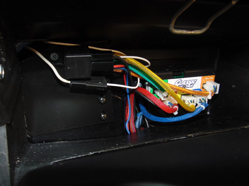

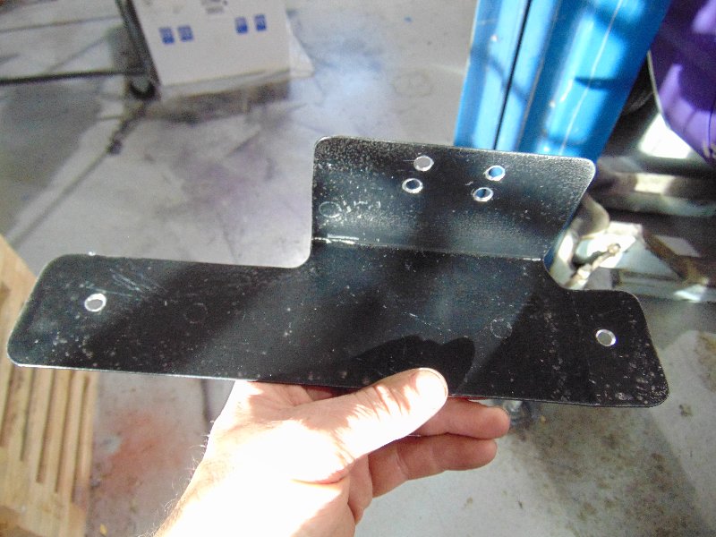

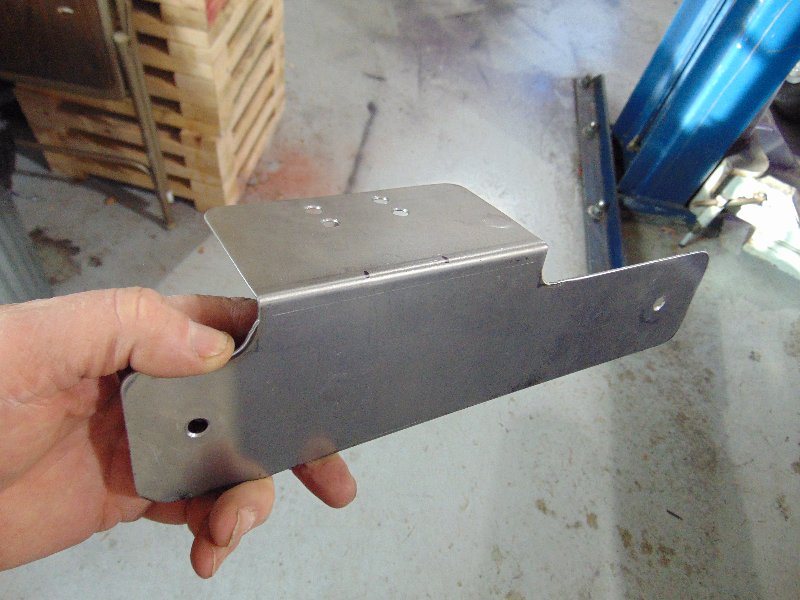

A couple of suggestions: I have the CAA system on my 70 Dart.
1) unless they have changed things there is no bracket for the electric heater control valve. Below I will post my bracket. I would suggest that you make one that suits you. When I asked CAA said tojust let it flop around with the heater hoses. NOT.
#2 I trashed their itty bitty glove box and modified a later plastic A-body glove box and that let me mount the controller and relay in the glove box - protected but accessible.

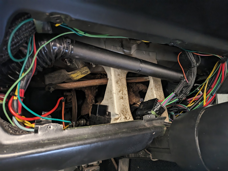

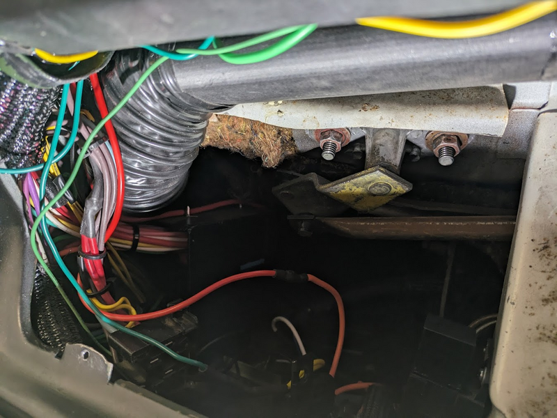

3 or four folks on here tried to figure out the ducting a while ago, but no magic bullet. I ran the duct high and the wiper arm grabbed the duct and pulled on it and caused a main power wire to come on and off until you turned the wipers off. We of course found this out in driving rain on a twisting piece of two lane on the California coast, with the ignition cutting in and out and nowhere to pull over. We finally got off the road and I ripped out the duct and left it out for the rest of the trip.
Find us a fix and be our hero!

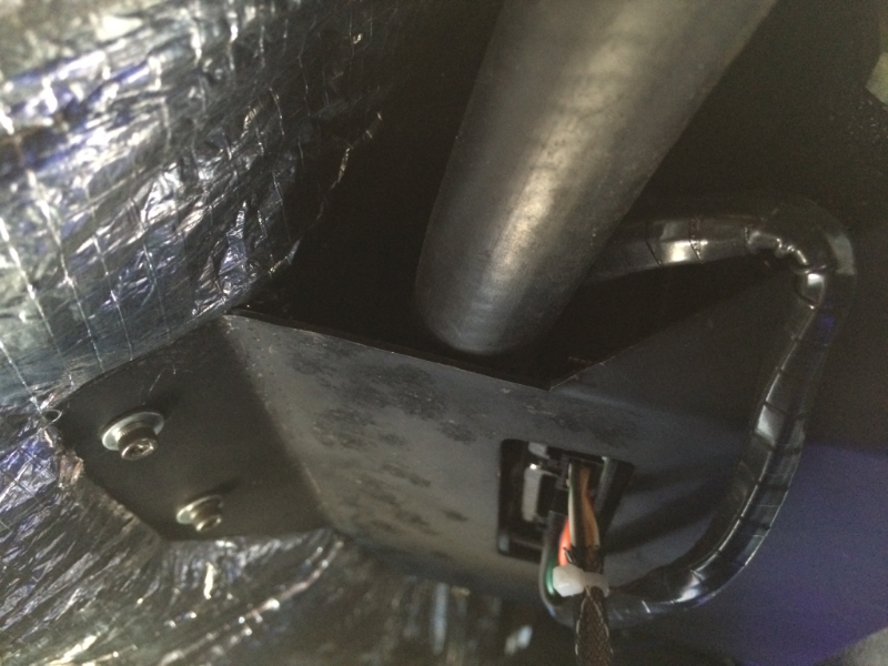

My buddy 3D printed this oval duct that you can stuff in the area above the gauge cluster. I have aftermarket gauges, but this worked great for me. He can print more, I'm sure he still has the CAD models. If people are interested I'll try to get him to jump on here and give everyone a price. It was 2 pieces and I glued it together with JB Weld Plastic weld.
