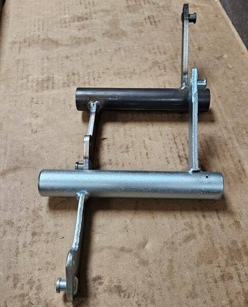

My 74 Duster project has hit a clutch linkage snag. I have a 360 with a Tremec TKX and the standard 12+ inch clutch fork blocks the adapter pipe from my TTI shorties. I know they have a 10 5/8" fork for small blocks that would solve my problem, but it will put a pretty severe angle (about 30 degrees) on my clutch adjustment rod. I currently have the stock 7-inch z bar and have room to fit an 8-inch bar in to help move the lower arm over toward the trans and greatly reduce the angle. I may still have to relocate the lower arm on the z bar to help resolve the problem.
I haven't found an 8-inch z bar - does anyone know if they made such an animal? I could cut down an 10-inch z bar, but I would prefer not to.
Thanks
Thanks, I'll look for an A body slant 6 z bar to see if that will solve my issue.
It kinda looks like you may need to modify the z bar to similar as the long tube headers .
Be sure to "clock" the lever correctly when rewelding, or adjustment may be limited.
Good luck.
Dan is right. So cut and re weld the arm on the rod/fork side over about half inch, or buy the modified version. Its required when using the tti full length step headers.. and apparently the shorties too, unless yoy could get a slight bend in the pipe below the z bar.
Thank for this information everyone. It looks like the modified z bar has an inward twist on the lower arm that would reduce the angle between the clutch adjustment rod and the fork. If that is the case, that may resolve the problem. I'll let you know!
Well, after talking to Dan about my unique mechanical clutch linkage issues (combination of Tremec TKX and shortie headers) I am giving up and going to a hydraulic clutch. Probably should have done that from the start.
So I wanted to ask what people's experiences were with installing hydraulic systems on a TKX and which systems are the best (and which should be avoided). Thanks in advance!
