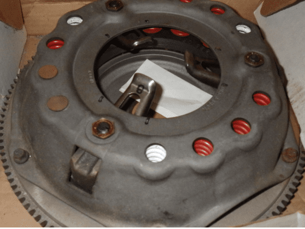

None of the parts look worn. This is the clutch kit I bought from RockautoHave you checked the linkage for for abnormal motion? Worn torque shaft bushings, frame and bell studs, bent or worn fork pivot, or combinations of those can cause this scenario. It helps to have an assistant work the pedal travel while one watches for the motion. It should be tight throughout. Also look at the engine and trans mounts while your there.

The throw out bearing had the plastic sleeve and it wouldn't stay on the fork when I push on the pedal. It was sloppy on the tranny snout . I swapped it with a used one I had laying around that fit better.
This 4spd setup was untested to me as I got it in a package deal basket case cuda project.
