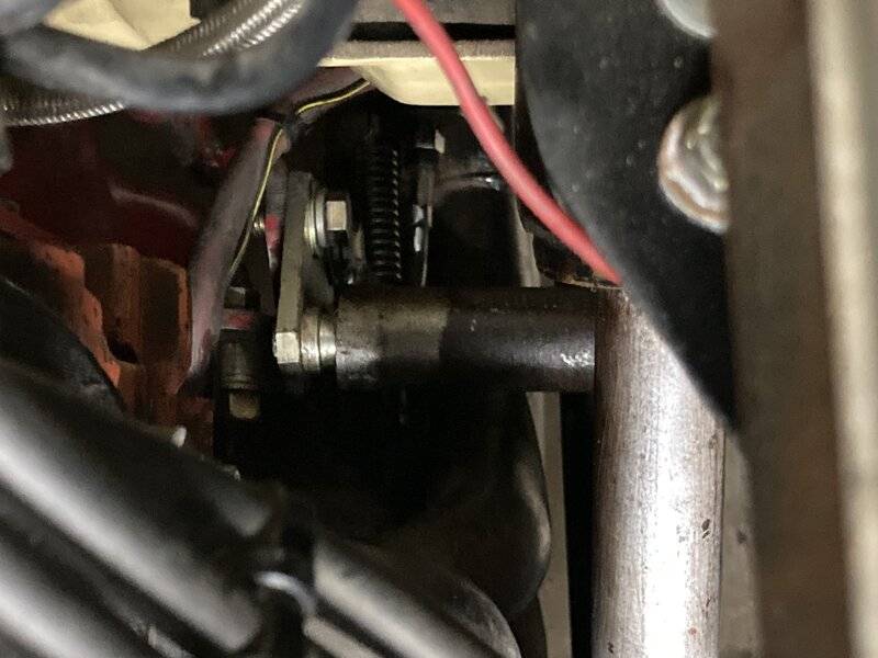

Yep, it was a bad call. I also bent the clutch adjuster rod (I had to weld the z-bar arm to the far side to clear the header, it wasn't the best angle to the clutch fork). Ended up braking it in half, after welding that back together everything seemed to be working fine......... Except for the grinding of every gear, not enough throw.
I'm beginning to hate this lakewood bellhousing with a passion. Thing is fricken huge, 1000 bolts, everything has to be moddified, end rant.

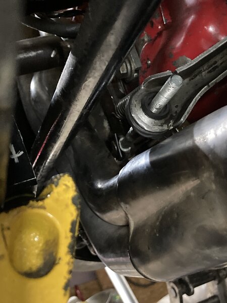

I too have issues with a Lakewood, poor adjustment rod alignment, changed z-bar around. Really hard to push clutch in, and it's a diaphragm. Parts otherwise are correct. I should just take it out and put my stock one back in. Not asking for help, correct parts are in it.

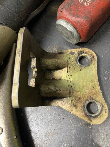

Swapped out the clutch fork pivot (cracked, wonder why) and the ball stud bracket (had both on the stock bell).

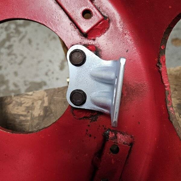

Looks like you are running a LW bellhousing. In an A-body SB application, you need to add material under the vertical part of the pivot bracket inside the bell. Can you see how the pivot is not fully supported where it bolts into the bellhousing? It's likely to happen again if you don't fix what caused the issue.

Thanks for the heads up, I read a few posts where people had added a spacer to shim the pivot towards the clutch (Thought that it was more to fix a problem with engagement).
The reason the pivot cracked in the first place was because I pried on it like a jackwagon.........
I will certainly entertain the idea of putting a thick plate between it to keep it from flexing, super stressful trying not to drop stuff into the abyss.

That is exactly it !
Had the same problem many , many years ago !
If you intend on street driving these things,,,you really need to extend that mounting bracket .
It really should have been twice the width from the factory to provide enough support .
It’s easy to do while the bell housing is still on the table before installation .
Anyone reading this should be proactive and act accordingly,,,before it happens to you !

Looking back it was more my fault than anything, the linkage was crooked as all get out causing clips to pop off, stiff pedal, etc. Now that it's all straightened out the pedal feel is great. I've got enough fluid leaks........ :lol:
