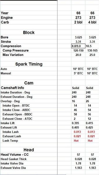

I have been researching the posts on the Commando 273 cam specs as I rebuild my 66 Commando 273. My engine guy is asking for the "full specs" for the Commando 4 bbl cam including "duration at 0.050". From the stuff below, can I glean all that I need?
From 66fs 's post on another thread:
The Commando cam works very well. We measured an original 67 Commando cam with 50,000 miles on it at Racer Brown's Cam Doctor's Analysis.
Intake:
110.4* center ATDC
202.8* duration at .050 Crank degrees
.405" net valve lift
Exhaust:
110.4* center BTDC
202* duration at .050 Crank degrees
.414" net valve lift
From other net-sources, what the usual "published specs" show is:​
This information is posted on here "somewhere", but good luck finding it. I think our search feature is worse then ebay and that takes some doing.
Just so you know,
For a True 10.5 hi-compression 273, that's a pretty small cam. Using modern gasolines, you may have cylinder-pressure issues; which is likely what your engine guy is wanting to avoid.. (see note-1)
Since it's a solid, the hot-lash (013/021) is gonna give away some of that advertised duration, and some of that lift. I was remembering that aftermarket Solid-lifter cams are usually spec'ed at 020 tappet rise;
but since, in this case, the tappet-lift for the advertised is not specified, the numbers are still somewhat vague, and
so again, adding more vagaries.

I made the spead sheet with the factory service manual data... They don't give any dur @ .050" in the manuals...
I have been ridiculed for trying to estimate it by interpolating from cam data from the MP catalog...

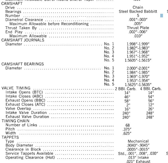

I did and page 9-75 says what the "published specs" above do. My guy is asking for duration @ 0.050 as he says that this tells us the real shape of the lobe. The duration at 0.050 is not on the specs there.
Duration at .050 wasn't used back when those cams were made. That all started in the 70's I believe to put all the aftermarket cams on a level playing field. Before @.050, the manufacturers would measure their cams at different lifts and it was near impossible to compare 2 different grinder's cams.
