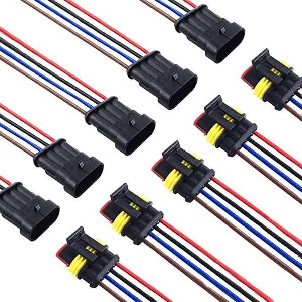

If you want to ditch some of the factory dash board connectors, I have bought the GM style connectors with pigtail wires. They are on Amazon in a variety of pin counts and are pretty cheap. If you have a soldering iron and some shrink sleeve you can really improve the 50 year old connections.
^^I assume you mean soldering pigtails to the board traces^^?? That is exactly what I ended up doing wth my 67 (I'm a cheap SOB) but at the time I used Molex style connectors from RadShack which of course is gone, but there are other sources of Molex / similar stuff.
Yep, exactly! There is a pretty good variety of pre made connectors with wires available so you don’t need to assemble them like a molex. A little more work, but when you are done, it is for good. I see if I can find a picture.

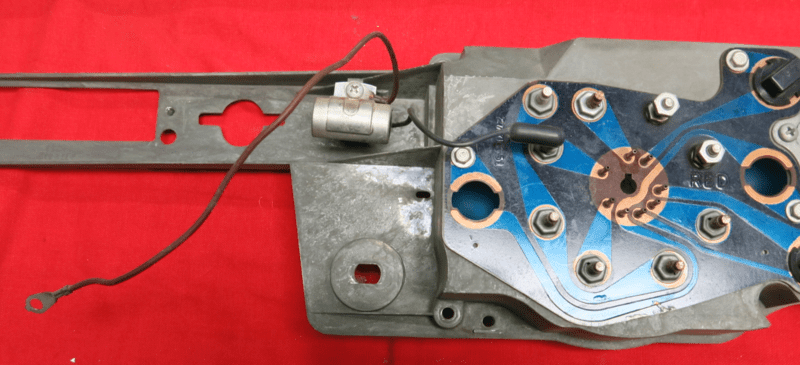

FWIW. This appeared to be the original ground wire on this rally cluster.
Other ring terminal attached the bottom lip of the metal dash at the radio support brace.
