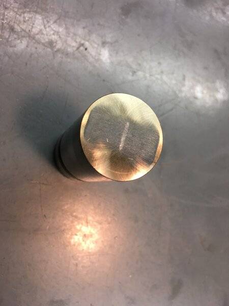

A buddy developed a tick in his low mile 440 and found this. Obviously the lifter wasn't turning in it's bore but he was able to remove it easily with a magnet. He read on the net that others have had the same issue possibly caused by the cam not being ground with the proper bevel to make the lifter spin. Anyone have the same issue or heard of it happening? I know Comp has had a lot of cam and lifter issues in the past few years. I don't have a photo of the cam lobe but I can't imagine it isn't damaged as well.

Sure looks to me like there's a pattern of the cam lobe wearing on the outside more, no spinning of lifter. But I can't say if that's the cause or the effects
I have a Crane lifter worn just like that and about 3/16" deep. Cause was too much lift, retainer hit the guide, bent the push rod. It only takes one to ruin things. Better look it all over and check clearances, push rod length, correct lifter load, rocker geometry, etc.

I’ve removed two cams from motors that had lifters that looked like that.
One was an Edelbrock cam from a SBC that only had one lifter like that.
The other was a “white box special”(no name/no numbers on it) that had a few like that, that I took out of a 360.
I never checked the one out of the SBC, but the one from the 360 had almost no lobe taper.
The lifter in the OP looks like it never rotated........ which should have been picked up during the valve train assembly process.
There’s obviously no problem with the hardness of the cam or lifters, or the oil being used.
If there were, there’d be a hole in the lifter.
The amount of lobe taper for a typical performance cam is .0015-.0020.

I was taught to make a few strokes of the lifter bores with a brake hone, after checking size, to help insure rotation .
Hope it helps someone .
Yep, that was done by the machine shop.

Hey Mike, I had a Comp lifter to that exact thing awhile back. Thought for sure I posted some pictures here on the site but unable to find them. I believe it was around 2019. I caught it a little earlier by the looks of that pic. After inspecting the cam real good I decided to throw another set of lifters in and run a complete break in cycle. Have had zero issues since.
