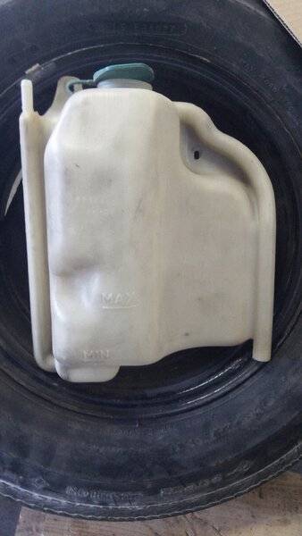

heres a later tank for a visual...
radiator line goes in at top and tube runs down to bottom (left side)
puke line has opening near top of bottle (right side)
