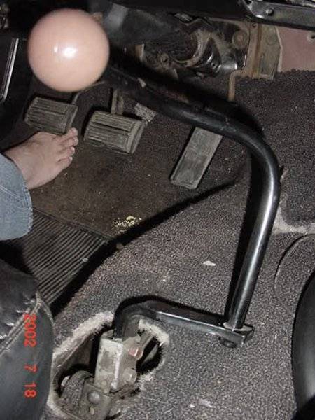

The correct shifter depends on when the car was built, but I don't know the cutoff date. Early cars had the Inland reverse lockout shifter and later cars had the Hurst. Console cars had different handles than non-console, so there were four different handles. Here is the '68 Hurst console handle, except it was originally chrome. I had it powder coated as the chrome was in bad shape and the powder was free.

thnks for pic ans reply - is that ball reverse thread by any chance? that looks like my shifter but mine is chrome and has no hurst logo - does yours? also not sure what you mean by 'console' shifter.

The threads on all shift handles that I have ever seen are right hand. This is my son's shifter with the console installed.
