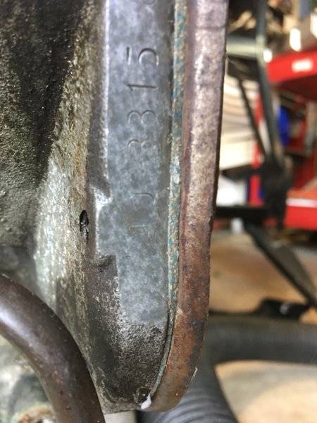

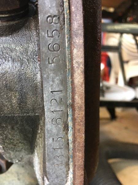

The 4028815 is a 1978 360 999 transmission with lock-up converter. If the trans has the original converter with the weights on it, it is for the 360. Stock flexplate is all you need.
Final update and thanks to all for the help.
I bought a stock flex plate from Mancini. $20. Used the stock converter with the welded weight. Bolted her up, no vibrations and she runs perfect.
