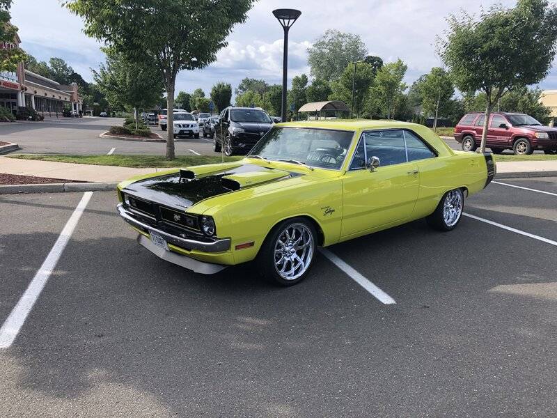

I painted mine gloss black - it isn't a stock car and gloss is a lot easier to take care of.
Thanks for the info! Thats what I figured, I just wanted to make sure. If you dont mind, Id like to have a copy of that diagram and instructions, it would be cool to have. And great looking car, the gloss black looks really good on there too :)
View attachment 1716338121View attachment 1716338122
Oh my lord that is a beautiful car!
