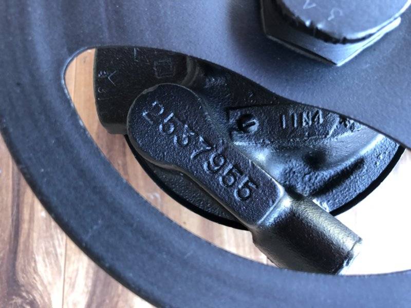

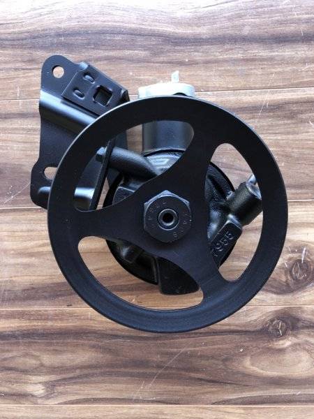

I have a pump that was supposed to be from a 68 383 barracuda and was wondering if anyone knew the correct part numbers for it? I read somewhere that they didn’t come in 68 so I’m slightly confused. Any info would be greatly appreciated.

Yeah, I saw some conflicting information on that. It does appear to be the same from what I can see based on your pictures. Thanks again for the help.
Jake

I agree, it looks like a 67 273 pump.
Jake
