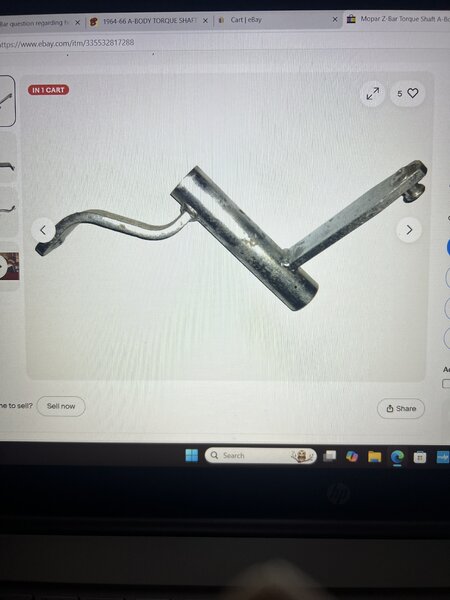

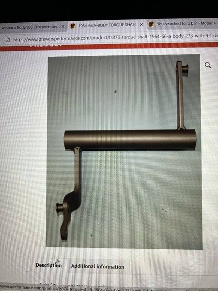

I have a ‘65 Barracuda with a 273 and a 4 speed 833 transmission. I’m seeing 2 different Z bars for it. Can someone confirm which is correct?
One has a straight arm and the other one has a curved arm, see photos
Thanks
First pic is correct.
Your second pic is for 67 and newer A body with BB. No where in my description does it say i
Your second pic is for 67 and newer A body with BB. No where in my description does it say it fits the early A body with 273.
The second pic was taken from an eBay ad
The one for yours says it fits a 63-66 A body with a 10.5 bell. I’m going with yours, but wanted to make sure I was getting the right one. This photo is from the eBay ad
