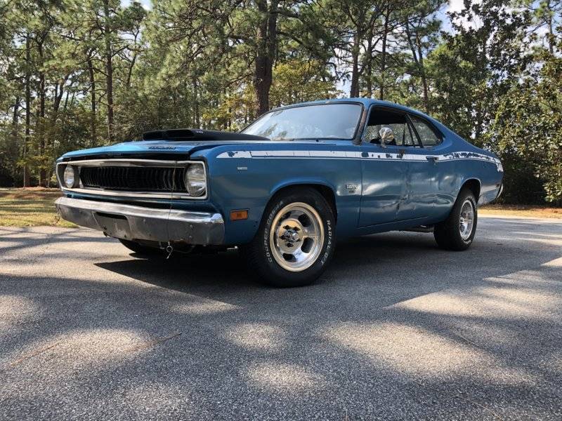

I have finally fixed this PITA problem. I was going to just replace the chewed up poly LCA bushings with some rubber ones but I couldn’t get the outer bushing sleeves out of the control arms to save my life. I ended up damaging the factory LCAs and left the car alone for a while. I just recently bought some QA1 tubulars and decided while I was in there I’d go ahead and get their strut rods and some PST 1.03 torsion bars. I got it all installed yesterday and PROBLEM SOLVED!
View attachment 1715403585 View attachment 1715403586
Amen and Congrats! I know you feel much better! Been tough on you, but you prevailed!
I am pretty sure I can see gaps in your upper control arm eccentric bolts. You have an aftermarket control arm. Looks to me that the bolts may be tight, but there is not enough thread to clamp the control arm. Even the alignment shop cannot fix that.
Looks too me you assembled something incorrectly or parts were missing. Maybe talk to the control arm manufacturer and double check your assembly.
This problem has been solved. It was the LCA bushings
If you ever had LCA bushings that bad you would understand. They were very bad. Like some I do believe there is space in the upper A mounts that looks suspicious as well. But the owner knows the difference and feels good about it.
In fact I commend him for seeing it through. He was lost a year ago and a nice recovery!
Yes, the comments about the space on the uppers having nothing to do with shot lower bushings is what i was commenting on. Like you, I'm glad the OP is able to enjoy driving his car again!
