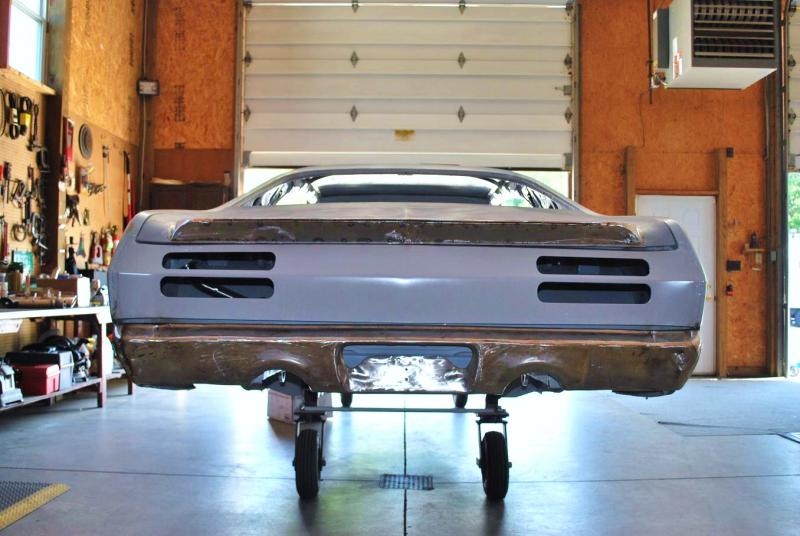

All you have to do is ask since I've been there and done that...If you check out my build (link below) specifically page 53 post 1320, page 55 post 1354, page 56 post 1397, page 57 post 1410 and page 58 post 1434 there are lots of pics of my rear bumper modification.......... enjoy .

Honestly it wasn't that complicated...once I found a damanged bumber and cut out a big enough area around the Dodge Ram opening to give me room to work without being in the stamped radius I traced the pattern onto my dechromed Duster bumper and used a cut off wheel inside the line to give a nice close fit and welded it up...(if you cant weld that well or not at all I'm sure if you got everthing cut out the way you wanted it someone could weld it up for you) and then I just ground the welds flat. It really didn't take more than a couple hours. The rear metal spoiler was the same thing I had never tried something like that before but figured the worst that can happen is I need to get another deck lid if I screw it up, I started with some 1/4" steel rod and started bendinging it into a shape I liked and literally within hours the spoiler was framed. Granted I am a Fabricator for the Air Force so I work with metal on a daily basis so I may be a little more comfortable doing this but I have never done these type of projects before but if you have some basic tools and a clear vision of what you want to accomplish you should be able to pull it off. Okay there's my pep talk for the day.
Orangewagon - That's bad a$$ lookin' nice job! Love it...
Thanks, I went through several types of tip ideas before the light bulb turned on to this design. I just started working on the front bumper also, shaved 2" off the overall length moved it back toward the grille 1" and will be stud mounting all the factory bolt mounting holes, filling in the jack slots removing the license plate area and replacing it with a pair of driving lights (like in my current Avitar). If you feel like checking out the pics, I've posted several so far on my build thread (Link Below).
