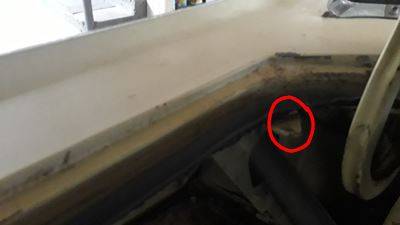

Also, I am missing the trunk light/switch part harness as per attachment. Could this facility be an option for the vehicle (no indication on the fender tag of such) ? Just seems like an odd facility to remove. If I did have the trunk light/switch then where would the light and switch have been placed ? I have a left side deck lid rain channel lip with a hole in it (attached) which I assume would be the switch location so where would the bulb be located ?
The metal tab is there on all A bodies that had it as an option. My 67 Dart Convert did not have that option so no light or wiring. You could buy the parts and add it if you wanted to.

Hi Dana67Dart + everyone else. Yes, the small dome lights just above the floor pan under the arm rests on both sides. Maybe someone was looking for some privacy whilst on the back seat, who knows. Sure, I'll just join them back up as I found a cut length 12" or so long behind the rear seat. Very odd. Yep, figure I'll just buy the trunk light/switch harness from the connector near the top motor and splice it in. Was tongue in cheek on the wiring colour; I have to battle a dingy garage, crap lighting and like you say 50+ years of road grime. I look for continuity too for confirmation where I need it. My rig is a non-AC car so I can see the empty bulkhead terminals for the motor and compressor and fortunately do not have any wiring hanging in the wind (that I cannot trace from/to something so all good there).
