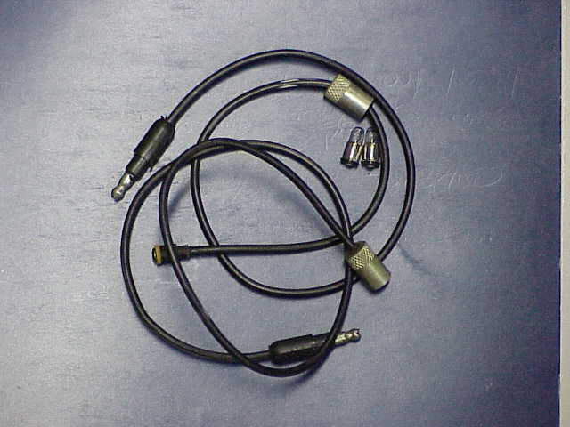

I got a rebuild kit from a Canadian company. It seems to be great quality. Everything was included except the underside brackets which I sourced elsewhere. I went to put the new power wire into the housing only to find... it won’t go in. Both ends are too big for the slot on the bottom. I am guessing this means I need to cut it and install and then solder back? Anyone confirm this?

Like these?

Either end will not fit through the slot in the body of the housing... which I cannot find a good picture for. I did read where one supplier provides the bullet connector and shrink wrap separate so you can install the wire. I am guessing that is the answer. I just wanted to make sure I wasnt missing a magic solution.
Those look to be correct for the turn signal indicator. How about a photo of the light housings to see what the problem is. Those should just thread into the bulb holder.
Yup. The bulbs go into the indicators "like a .22 shell" Then the wire fitting simply screws onto the bottom. If they won't fit, one of 'em is made wrong.
