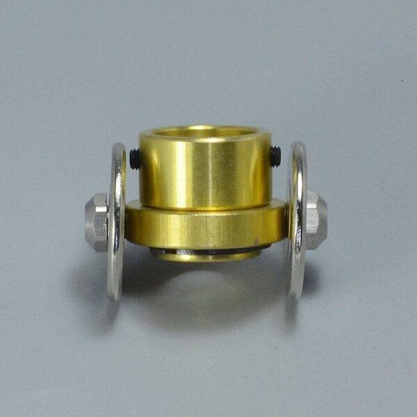

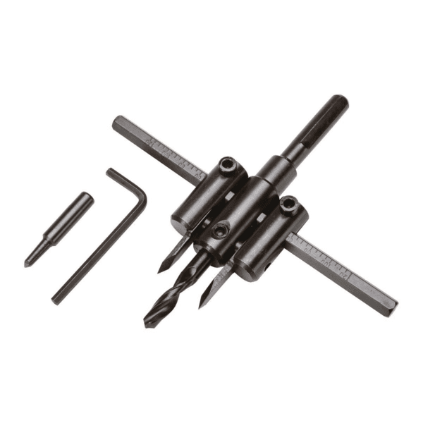

Cutting some 80mm holes in 16g plate steel. Do I use a titanium tipped hole saw, or one of those adjustable cutters that fit on a drill and have the 2 bits on a T bar? They say they cut light metal but I'm not sure about that. Any experience? I'd have to use a hand drill on the hole saw as my old 'penny store' drill press has some bad run out and makes hole saws not run true and make some nasty cuts. I could plasma cut these but I'd have to make a wooden stencil to get the circle cut as a circle and not some weird shape.

Find some 16ga. 3" exhaust tube that is swedged open to go over 3" pipe, should be just over 3.13" and use that as a plasma template.
Whats the tolerance on the 80mm Dia. and how "circular" does in need to be?
I haven't tried this but.....what about welding a 1/4 x 3" bolt to metal and use a string around it and the plasma head and do a 'ring around the rosy"? Just came up with that ****!!

Yeah, I never figured they would cut anything but drywall, and I have netter tools for that! Lol
Tried it on wood also but it has to be perfectly vertical or it is nearly impossible with a hand drill. A drill press was better but far from being a decent job .
