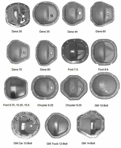

You sure they ain't 44's? Somewhere on the web are measurements between bolt holes, etc
Can you weld?
Weld a bung on it where you want, and plate cover the hole for the rubber plug.
Just a guess from your pictures, but that looks like a 44 in front and a 60 in the back. Could also be a 61. Beware. More investigation is necessary. 4x4 shop near you?
You'll need to wire brush the dirt and rust off, but this tells how to ID Dana axles. In the 2nd diagram, notice #3. That's the model number. 60, 70, etc. that you're looking for.
