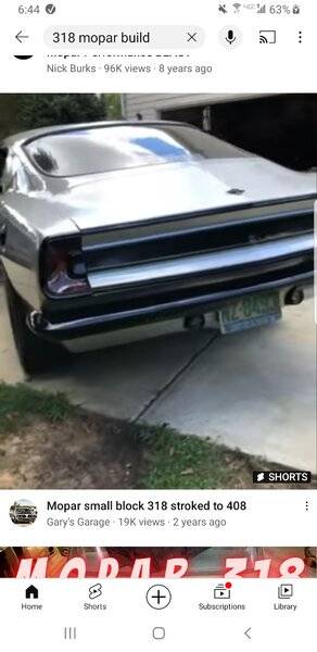

I never heard a thing about .030 over, he clearly stated its 408 cubic inches, so explain how much stroke it would take to get 408 out of a .030 over 318.
Here @Dan the man this is where he says it's a 408 stroker

I think I have a screenshot of one of his videos way back when he posted it was a 4" stroke deal. He loves to call it a "318" because it makes him look like hes accomplished something no one else has. It's all internet bullshit
