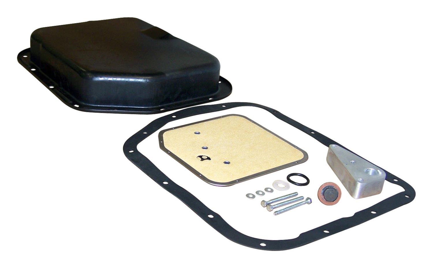

Any feedback on the Crown pan? Extra capacity and drain plug is a no trainer IMO
Deep 904 transmission pan?
I don't think they have that one available any more. I like this one on Summit's website. Deep with a drain plug, filter, gasket, extension, and hardware.
Warning: the A500 pan by Dorman is deep and then has a drain plug that is another 1/2 inch closer to the ground. The pan is well behind the front wheels and just one too tall parking lot speed bump hit my plug hard enough to crack the pan in front of the plug. I ended up welding the Dorman plug hole up and installing a generic drain plug kit on the side of the pan. It won't drain the pan 100% but more than enough to promote a mess free filter change. I see from the picture in post #11 that the Crown pan has a "tented" drain plug like the old MP deep pans...

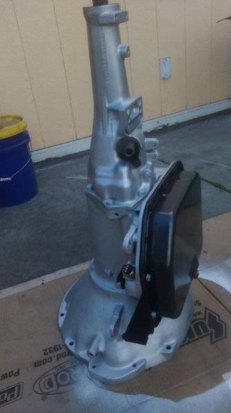

Got mine today from Crown via Amazon.
Thanks for the link @toolmanmike .
First glance looks good. Ill chk pan for flatness
The extra guts in the main trans body for an A500 hang out of the bottom of the trans where a 904 Valve body is, so the pan contains all that stuff, but the perimeter of the pan and case is exactly the same as a 904. if you lay the pan flat (not held up by the drain plug) and measure to the top of the mounting lip, how tall is the pan?
I'll get measurements and post Mike.
Mike, it measures 2 1/8" on outside from pan to lip. Its pretty stout pan too. I need to tap corners a bit to level, but happy with it so far.
