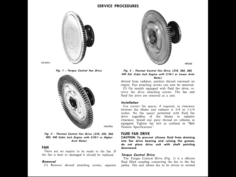

Mike...could you swap your electric fan for a pusher instead of a puller? If you aren't installing AC, that might work. If you get the early style water pump, the bottom radiator hose will be on the drivers side. Plus, your present timing marks on the timing cover will be hidden by the water pump inlet. I'd be tempted to ditch the electric fan and run a good clutch fan.

I am running a rad/shroud/and 7-blade-fan from a 1973Dart 318 with A/C. The rad has patches on it's patches.
By it's trapspeed, 93 in the Eighth, that computes to over 400hp.
The thermostatic clutch is off an early 2000s Ford pick-up; it works fabulously.
Am still running 50% antifreeze, a 195* Hi-flo-stat, and a Milodon Hi-Flow pump with the HD shaft and anti-cavitation plate. She runs at 207*F, under all conditions, and is stone-axe reliable.
