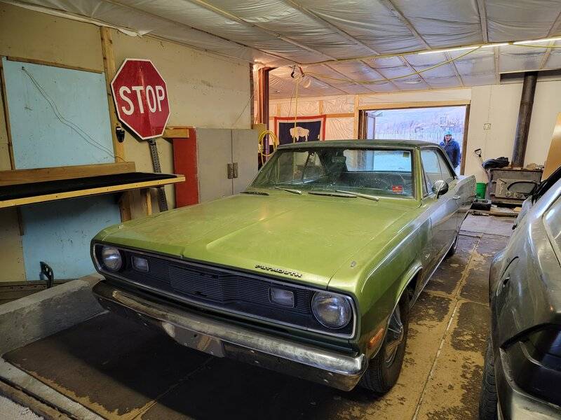

I acted on sort of a crazy idea but I thought maybe some folks here may help me figure out the more complex details. I recently picked up a Kenne Bell supercharger kit with intake and all the wiring and injectors for a dodge durango/dakota with a magnum. I want to figure out a way to use this system on my ‘72 Plymouth Scamp with a 318. I work at a towing shop and we just picked up an ‘01 durango with an overheated 5.9 that I thought may help me fill in the gaps in what I’ll need to make this work. I also have a set of 360 “J” heads I’d like to use, since I think they will offer me a good compression ratio to go with the blower. I’d love to hear some insight from folks that may have experience with this kind of build, or even opinions on the way to make this work on a budget! Thanks in advance!
Biggest question right now: how can I use the supercharger kit’s magnum intake on a 318 with J heads?

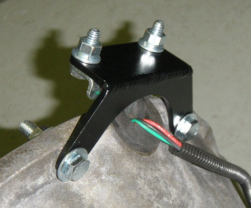

Or he could just buy this:
HiPoTek Crank Sensor Adapter Dodge/Jeep 3.9/5.2/5.9 Magnum EFI/MPI
