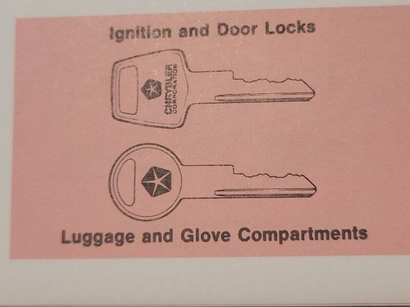

that's not how the lock set was i fitted to my valiant. that's why i said it. :thumbsup:
neil.
From the owners manual.

doors and trunk are one key and ignition is another.
My 69 and 72 doors and ignition keys are the same. The trunk are different. Get a little guy to crawl thru the divider and use a 1/2 inch wrench to remove the lock mechanism or catch, which ever one is easiest to remove. As others have said, get a trunk key and have a locksmith rekey it. You can buy a keyed set online for around $20.00 or remove one from another car you may have. Don't sweat it!!!!!

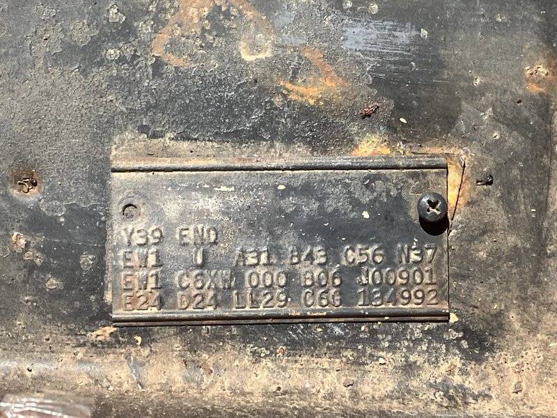

Looks to be R4 red.
All Dart Lites and Feather Dusters were 833 O.Ds I believe.
Cool project ! I think if built and tuned correctly 30+ mpg is attainable.
I had a Feather Duster with an auto years ago.
To me, these cars are cool for their "weird" factor. They were the last year of the A body and they threw what they had to get them to be more fuel efficient. The one that I have was built 11-75 so it could have been a 4 wheel drum model. The rumor that I heard was that after January 1 1976, front disc brakes were standard in all models. Is that right? Mine has a 7 1/4" axle with the big bolt pattern so it probably had front discs since I've never seen big bolt drums used on these cars. Mine is heater only....it isn't even coded for a radio and that surprises me.
