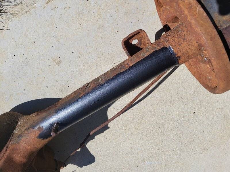

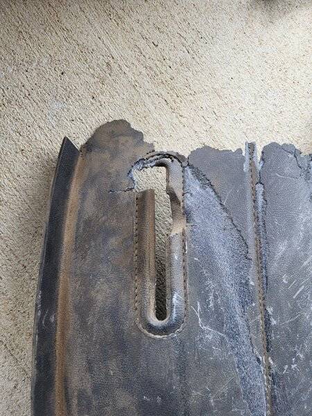

That might have worked, chem strip didn't do much as you can see in the first picture.
So I like this stuff!
No water.
Looks great to me on my recovered from the Titanic 8 3/4 rear.
I used a wire wheel on my grinder and knocked the scale back.
Then one coat looked like this on a test tube.

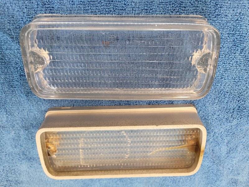

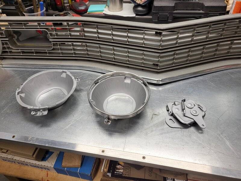

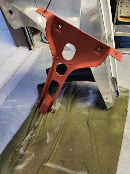

I got the headlamp buckets cleaned and painted.
Latch support blasted and primed.

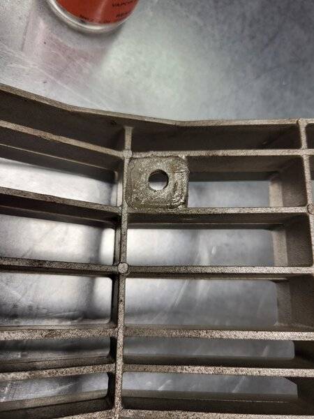

Fixed the two cracked supports on the grill.
And last removed a ton of z-bart rust goo overspray from the bottom of the grill.

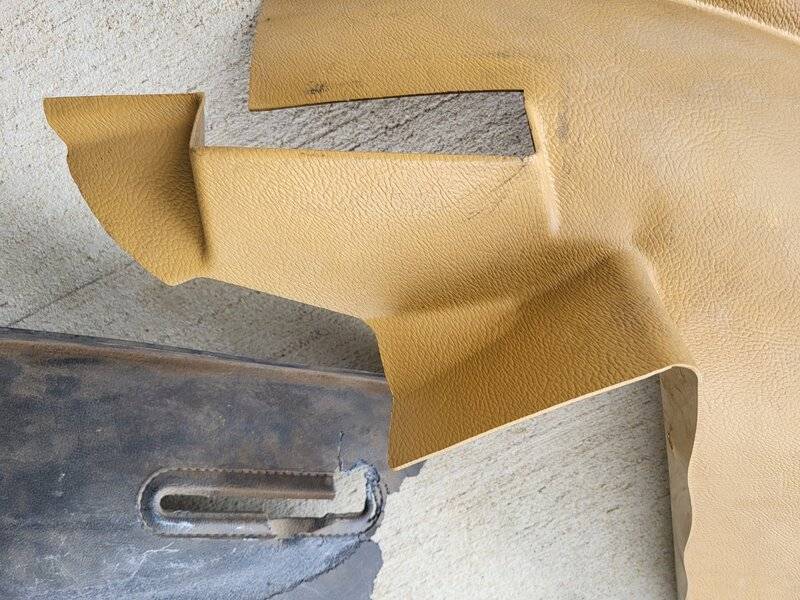

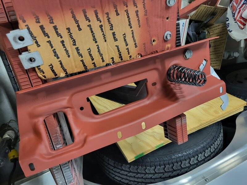

Shout out to RAT ROD AL for the wheelhouse cover.
It's the Tan one in the pictures.
It's for a 73 and you know Chrysler, they had to change the dumbest stuff.
The 73 is slightly different with some details.
I can make it work.

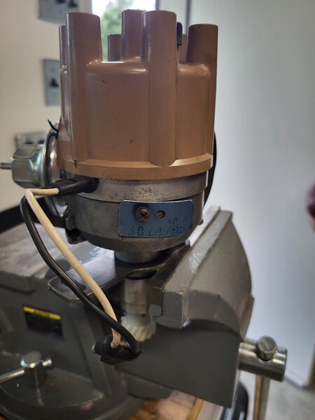

I had sent my Distributor to Bill in MO.
He got it all squared away, run on his Sun Machine and returned it with data.
Engine would not have started with all he found wrong!
Thanks Bill!

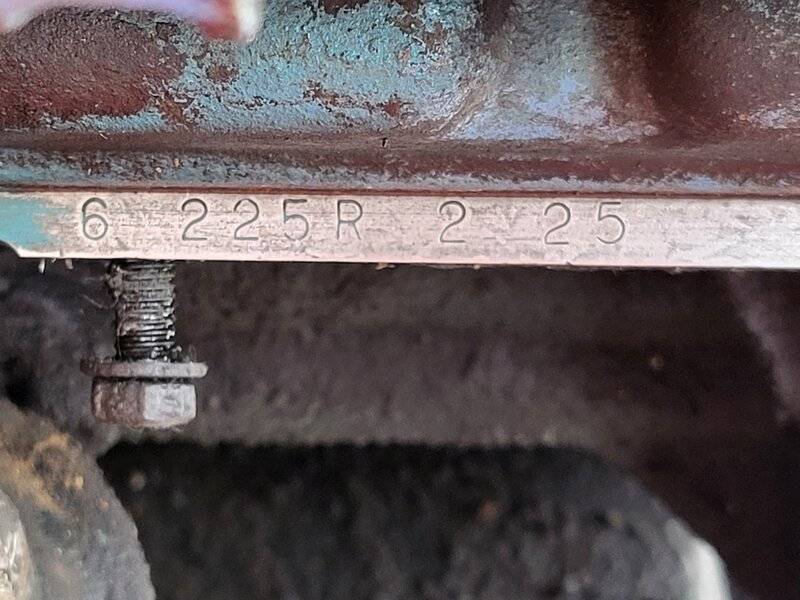

Original Engine, I found the VIN stamp.
Engine build date about a month before car build date.
Engine has a cast crank.

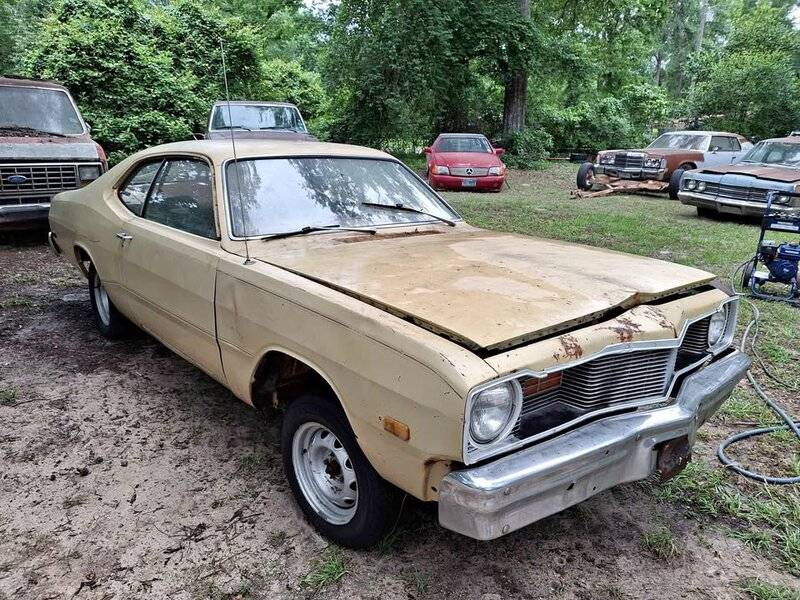

There is a Facebook page for Feathers and Lites.
A Lite was posted yesterday and it looked familiar.
I looked at the Fender Tag and dang, same car!
I had looked at this Lite 7 or 8 years ago.
It was missing way too many parts for me to buy then.
It was in an area called Lake of Pines Texas.
Now it's down near Houston still missing a ton of parts but pretty rusty now.
About 5 hours apart.
Poor little Lite :(
