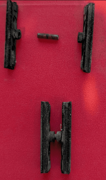

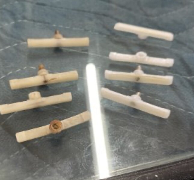

I have 2 67s and have taken parts off of other A bodies. the photo I posted came off a 67 Barracuda. all are plastic with a metal bar between
and its not 67 only thing, the same part was used for several years till they got rid of the vent windows

Please post a photo of your slides. When was your car built, maybe its a holdover from 66? I have a Nov 66 build and a Feb 67 build and I took some off a Jan 67 build, all were plastics

the OEM 67 would be black like in my photo the white one are later oem / aftermarket replacements

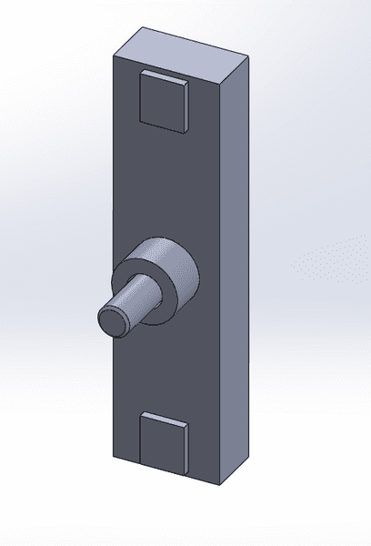

I started CAD for the slides but then the aftermarket ones came back on the market so I stopped development on it.
this is where I left off. looks like I did not get as far along as I thought.

I figured I would get back to CADing up the black window slides.

I'm guessing these are "Metal" 2588716. They have a VERY hard rubbery plastic with felt impregnated into it on the frame side covering a metal core.

Well at least now I have CAD for an OEM looking part!
the lip is where felt would start and wrap around the filleted face
lighter color would be felt covering
