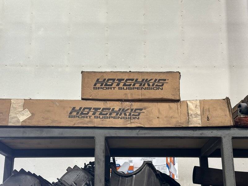

Here are my super custom (nope), one off (nope), hand made (nope), one of a kind (nope), only pair in existence (nope), hotchkis leaf springs.
And in these two special (nope) boxes, there is everything you need to build a super trick (nope), high end (nope), custom (nope), professional (nope), race (nope) car.
Are these the same springs as you bought 15 years ago?

Yup. At least 15 years ago. Bought the whole TVS kit and the springs were included.
I gotta ask...
How would you describe these springs??
They’re just an aftermarket 1” lowering spring for a 111” WB dart with the spring rate that hotchkis chose. No different than espo or MP SS or Eaton or any other spring that’s not an original.

I've had them in my Duster for about 7 years, I like them but I feel like they could be a tad stiffer. I have an adjustable rear sway bar and on the stiffest setting the car still feels more prone to understeer, however the suspension overall is far from optimized (needs good shocks) and my front tires are pretty old, a few years older than the rears and those are getting up there in age too.
They feel a bit stiffer than stock springs but nothing like SS leaves.
